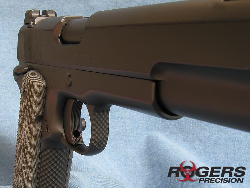

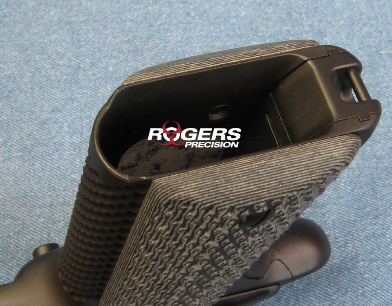

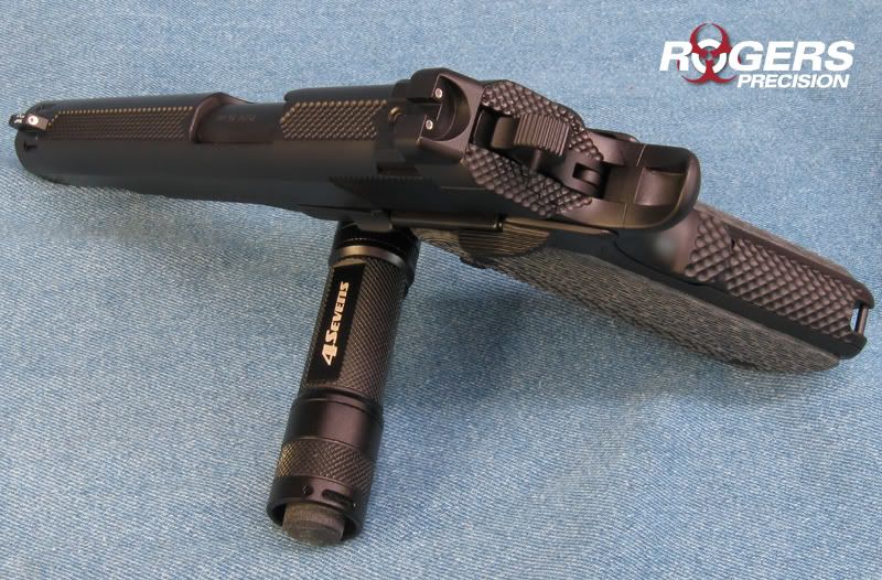

The build list:
Fit slide to frame. Weld and pin hardened inserts.
Kart match barrel.
Wilson barrel link.
Two Wolff recoil springs.
Rogers' 'Bobnose' including match crown, match bushing, golfballed recoil spring
plug.
Flatten and golfball top of slide. Arrowhead pattern.
Dovetailed front sight with Trijicon tritium lamp. Green with white outline.
Rogers' 'Tier One' rear sight with two Trijicon tritium lamps. Yellow with
no white outline.
Remachine rear slide serrations.
French cuts.
Ball cuts.
Machine 60 degree bevel on bottom of slide.
Rework ejection port.
Two, tuned and golfballed Wilson extractors.
Oversize, fitted firing pin stop with small corner radius.
Rogers' barstock ejector including remachining of ejector slot in slide.
Golfball rear of slide and frame.
Brown's 'Hardcore' slide stop. Reconfigured and golfballed.
Shorten and radius slide stop pin. Chamfer right hand side of hole in frame.
Barstock plunger tube. Permanently affixed.
Harden and polish slide stop and thumb safety plungers.
Wolff plunger spring.
Brown's wide ambidextrous thumb safety. Recontoured. Stop pin for right
hand paddle.
Smith and Alexander grip safety. High cut and golfballed.
Extended magazine release, Shortened, angled and golfballed.
Wolff #1 mag catch spring.
Greider medium length trigger. Internally lightened.
Wilson 'Ultralight' hammer.
Wilson match sear.
Wolff sear spring.
Wolff 23lb. mainspring.
Brown's mainspring housing. Golfballed.
Rogers' extended magazine well including modifications to mainspring housing.
Recessed lanyard loop.
Trigger job 3 3/4lbs.
High cut and golfball front strap.
High cut and golfball front of trigger guard.
Carry bevel package. Medium.
Davidson grips. Warthog texture. Black and grey.
Narrow slot grip screws.
Manganese phosphate and Cerakote all with 'Graphite
Black'.
CMC Power Mag +. Concealment base pad. Cerakoted.
Test ammo and range time.
