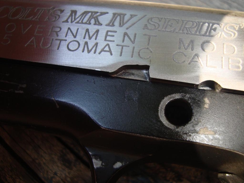

Crack at the slide stop pass-through window. It cracked up on the rail years ago and I simply milled out the bridge.
Slide appears cracked at the slide stop notch. They used to make them very sharp like this one-- most I see nowdays are radiused. This is the first one I've seen cracked here.
The frame is cracked in the usual spot, right where the slide bangs the frame every shot, foward of the slide stop hole. This gun was cracked there 4-5 years ago and I welded it. It re-cracked, which is not surprising, but it's the first I've had re-crack. It didn't re-crack on the other side.

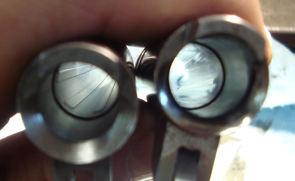

And the barrel? Not cracked. And definitely not fresh! A good opportunity to replace it? Yes. A good opportunity to see how many miles we can get out of one? Yes! Barrel still delivers accuracy that is satisfactory to this top shooter, outer wear and locking surfaces are 100%, mating with slide locking recess 100%, so..... let the research continue.
New barrel on left, "J"'s barrel on right.

Ned, perhaps you can measure/gage the rifling start, to see how far forward "J" has worn the leade?

Yes. Nothing that's wrong with it was really inhibiting reliability... for the moment. And like many cracks in 1911's, most or all of these are the kind of thing that would go just so far and then slow way down or stop. The typical dustcover cracks have never been more than a cosmetic and theoretical problem in my experience. I have them on one of mine and at a certain point the crack gets into very thick metal and seems to stop.
The bushing, even if the crack went all the way from back to front, would have still held together and done the job, I believe.
The rear frame crack at the slide stop pass-through window was my biggest concern but even that one..... had it gone all the way to, say, the mag catch hole, I'm sure the gun would still run. And the crack would stop there.
The crack, or suspected crack, in the slide, "J" needs to keep an eye on that. If that really took off and went up, and around the top, and down the other side, that would not be good but I think it would make itself known before the slide actually went into two pieces.

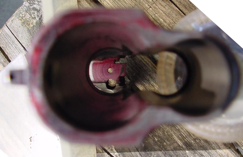

Patrick, I will try and find the time to make a chamber cast..... I imagine it in a small glass case framed in walnut, on the wall of that office we kick back in after being run into the ground by this Whirling Dervish of a cop.

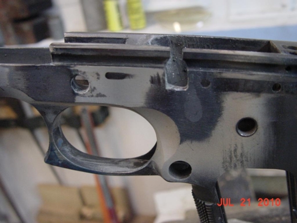

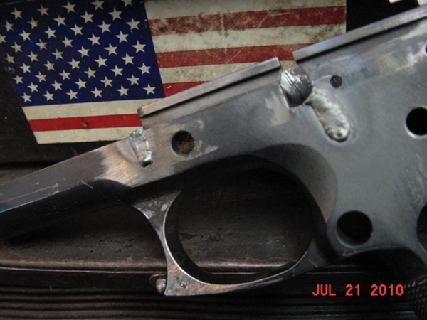

Here is one with it just-welded and one with the welding trimmed off. The slide stop pass-through now has a nice radius where the sharp corner that probably caused the crack once was.
