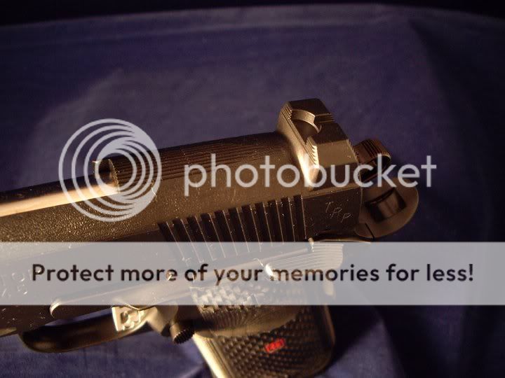

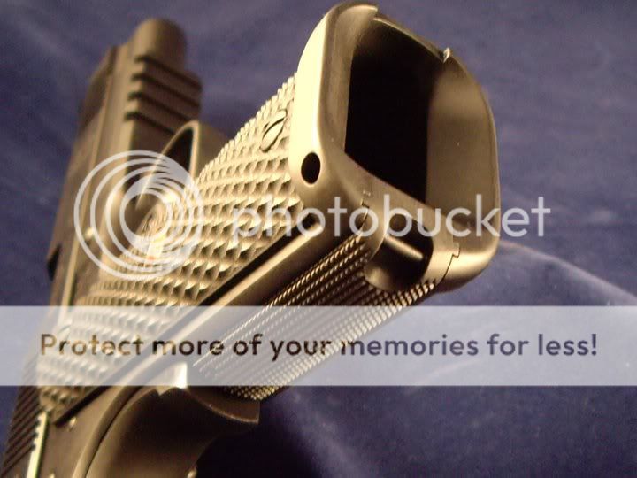

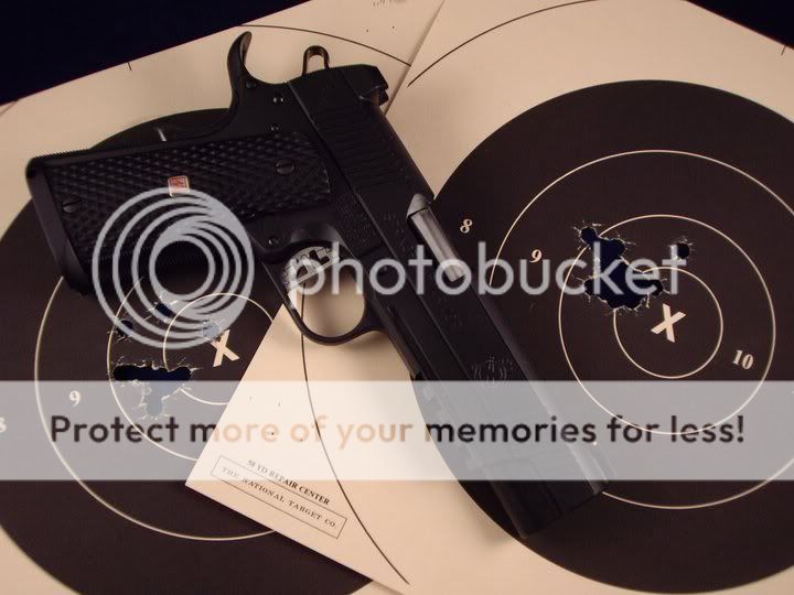

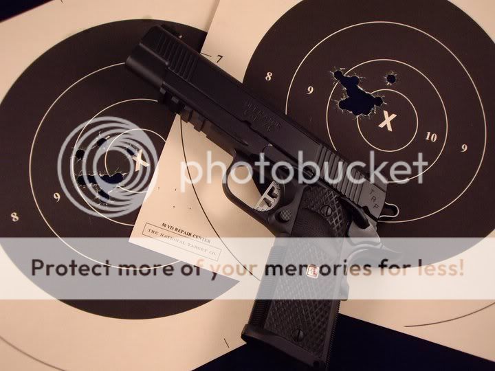

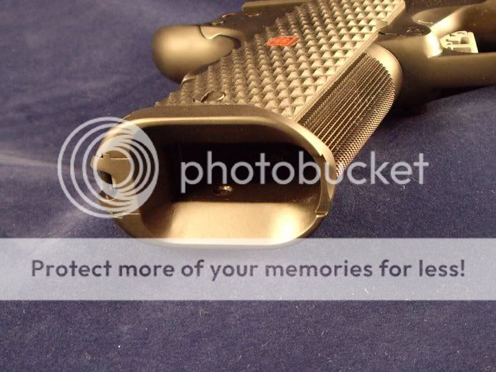

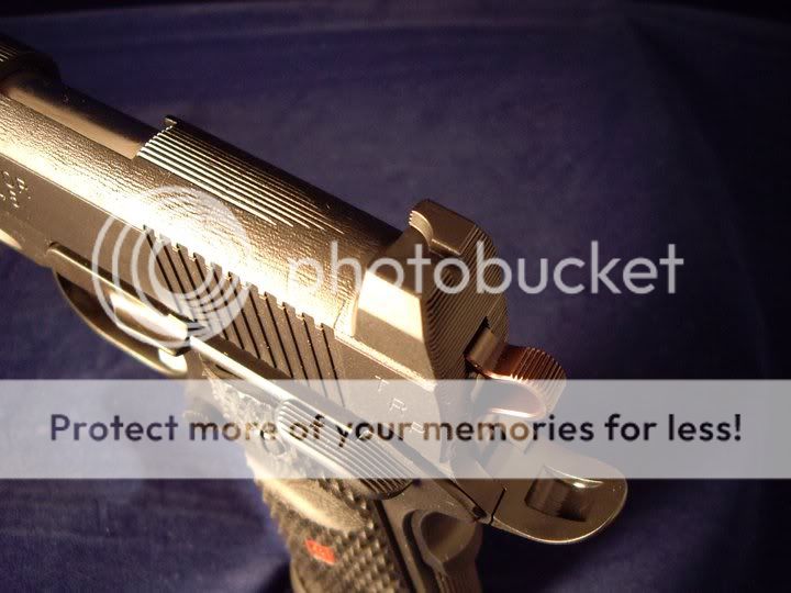

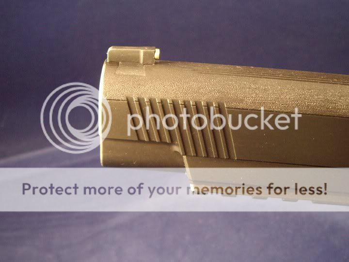

Here are the pics that some have been waiting to see. Let me start by saying the Joe is one of the best young pistol smith’s in the country. His customer service is second to none and he goes above and beyond to make a great finished product. During the build he makes you feel like a friend, not a client. He gives you regular updates about the gun and may even send you some in the process pics. You will not find this anywhere else.
One thing that I think makes Joe stand out is that he builds his business on three things….accuracy, reliability, and beauty. Well as you can see by the test target this gun is super accurate. Joe is one of the few smiths’ that guarantees less then 1.5” at 50 yards and sends a 10 shot test target to prove it. He also ran 500 rounds of all kinds of ammo through my gun before sending it out to make sure it is 100% reliable. I will let the pictures do the talking for the overall appearance and you can tell me if it’s beautiful or not….I’m biased anyway. Overall the gun came out great and will make an awesome duty gun. This will NOT be a safe queen and will be used on a daily basis.
So Thank you Joe for going above and beyond on this pistol and you will definitely have a customer and friend for life.
Here are the build specs:
Springfield TRP Operator full rail base gun (the only things left are the frame, slide, and 3 grip screw bushings.)
Kart .45 barrel with Chambers tapered sleeve cone and custom link. 1.5" at 50yrds guarantee
Custom reverse plug (standard GI guide rod)
Custom gold dot front and Deep Pocket(TM) Fixed rear sight
Cylinder and Slide Super match trigger kit and hammer strut. Trigger set at 3.75lbs
SVI trigger with flat insert
Wilson Combat bulletproof grip safety
EGW ejector, extractor, plunger tube and thumb safety
Chambers/Greider magcatch and slide stop
Chen weld on magwell and mainspring housing hand checkered at 20LPI with lanyard loop
10-8 signature grips
I'm sure I've forgotten a few things but on to the pics!

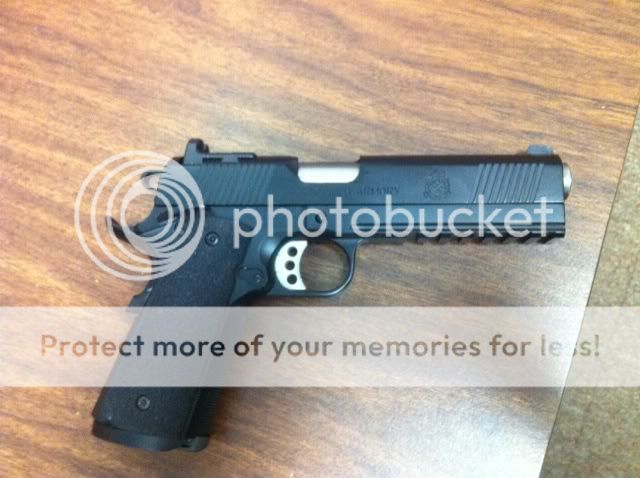

Before pic:
After pic:
