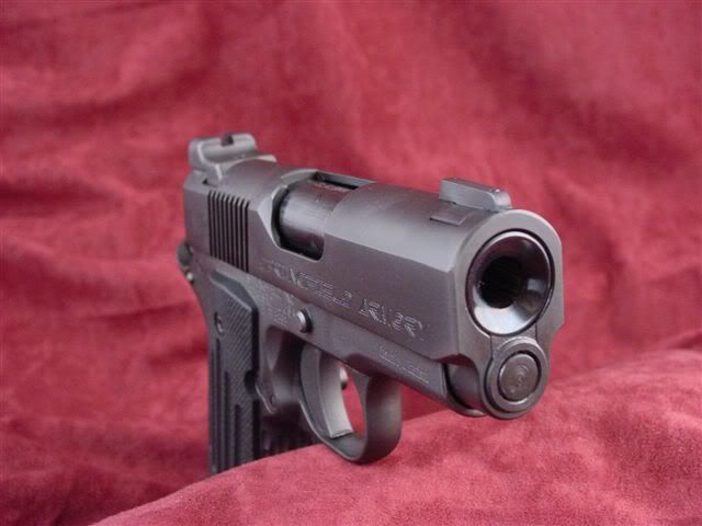

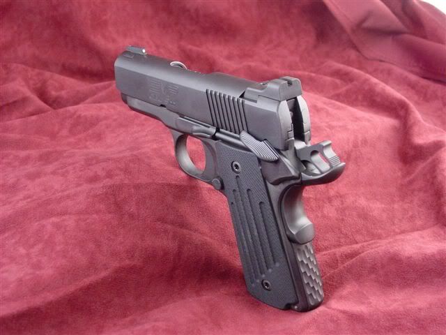

I got the EMP back and I am truly AMAZED by what John did! The fit and finish of the pistol is excellent and the parts were all dehorned via the "Carry Bevel" John did. I cannot speak enough about John's work, and his attitude. He is truly a great person and I am very thankful to have this gun. He was a pleasure to deal business with and I cannot wait until my next Harrison build! Everyone said John was good at what he does, but man there is nothing like seeing and feeling it in person! I'm at a loss for words...
I would like to personally THANK:
John Harrison (http://www.harrisoncustom.com)
Larry Davidson (http://www.davidsonknives.com)
Ryan Payne (http://www.thefinergrain.com)
I was able to take it to the range and run 300 rounds through it. I had a few hiccups in the beginning, but I blame that to the ammo (PRVI PPU). After I ran a few mags of that, I switched to WWB and it run flawlessly! I switched back after 100 rounds of WWB to the PRVI PPU and it fed everything without incident.
I ran the gun liberally wet for the range with Hoppes #9, but I did not have time to test Slide-Glide Lite yet.
Ok, now to the good stuff...
Build List:
Remove existing rear sight, fit and install new rear dovetail sight. Includes laser bore-sighting.
HD-005 Harrison Design Extreme Service rear sight for Novak cut, tall height
Remove existing dovetail front sight, fit & install new ready made dovetail front sight
Dawson Precision D/T front sight, Springfield / D Wesson, .200"
Install tritium lamp in dot configuration with white ring in non-serrated sight blade
Drill sight & slide for vertical roll pin in dovetail front sight
Face off barrel flush with barrel bushing and re-crown with deep dished, high polished crown
Fit and install match grade slide stop
H-D Extreme Service Slide Stop, .38/.40/9mm/10mm, blued
Fit & tune match grade extractor
Springfield Armory extractor for 9mm EMP
Fit Harrison Design trigger to frame and adjust fixed overtravel stop
Harrison Design Extreme Service trigger for 1911, short smooth face with fixed overtravel stop, natural aluminum finish
Scallop front strap, includes truing & high grip
Scallop smooth main spring housing to match front strap
VZ aluminum mainspring housing, Officers ACP
Wolff 23# Officer's hammer spring
Lower plunger, main spring, Officer's ACP, blue
Cap, main spring, Officer's ACP, blue
Mainspring housing pin retainer
Fit extended thumb safety
Ed Brown tactical extended thumb safety, S/S
Carry Bevel Package
Countersink slide stop pin hole & recess pin
Modify frame, MSH and grips for Round-Butt
Refinish complete pistol in matte IonBond DLC
Please excuse the poor picture quality.
Here are some custom grips by Ryan (Sarge) that turned out absolutely fantastic!!! I am VERY impressed with them. It's really hard to decide which ones I want to use, I love both, but obviously the Larry D's have a lot more grip.
Here is the range test. I used 115gr PRVI PPU and 115gr WWB. 7 yards, isosceles stance.
Here is about 100 round grouping into the center of the target:
This was about a 20 round group:
Obviously, if I do my part, the EMP will do it's!
Semper Fi

Ok so I wanted to give you guys a bit of an update. Not the best in the world, but I'll see what I can do...
Since I've had my EMP back, I've only had a chance to run ~800 rounds through it. These pictures were taken today, the EMP hasn't been cleaned in 300 rounds, and I will continue this at least until 1k rounds. I wanted to do a "dirty" report, specifically to see where the oil was wearing off, if any parts where wearing, what was getting dirty, etc. Usually I clean my guns immediately after I get home from the range. I like seeing pictures of dirty 1911's and seeing people actually use them.
Initial Impressions
The gun was fantastic, I was amazing when I received it and was excited to say the least. I went to the range and ran about 200 rounds through it and experienced all kinds of FTE's. After taking some knowledge provided by Quack and others, I pinned it down to an extractor issue. I tuned the extractor tension, went back to the range to fire another 300 rounds, and still had quite a bit of FTE's, with both FMJ and HP's. At this point I contacted John Harrison and the rest is history.
Fit and Finish
The fit and finish I honestly don't have much to compare it to. The lockup feels solid, there is a little play in the frame-to-slide, and after I got the EMP back from John, the grip safety is terrible. Now, this isn't John's fault at ALL, I believe it's from the poor fitment from the factory and the fact that it's hard to weld up aluminum frames. I've heard it's best to leave it alone, and that's what I did. In John's defense, I never even asked about fitting a new safety, I want to say again, this has NOTHING to do with him. Unfortunately, it's a rattle-trap. If I accidentally hit it, it rattles and I can shake it. I'm not really upset about this, but I'm not exactly happy either. Other than that, the parts John fit are superb, and extremely well done. The slide stop for example, is really tight and actually fairly difficult to remove and put in place. The trigger is also solid and feels great. If anyone is thinking about taking out the ILS system that SA uses, I can say without a doubt it makes a huge difference. Everything feels much more consistant and "easy." I believe the stock trigger pull is ~5 lbs. I want to say my trigger pull is probably ~3.5 lbs now, which is perfect. Nice clean and crisp trigger break makes a world of difference.
Malfunctions and Other Issues
One of the reasons I chose John was because of all the good words I heard about him. I was very impressed by the pictures of his work, and when I talked to him, he was a pleasure to talk to. John only called me once during the build, and that was to discuss my checkering issue. After John measured my front strap, he noticed that after truing the frame, I would only have 0.030” left in my frame. He suggested that because of the aluminum frame is weaker than steel, I opt for something else. He didn’t want me to have any issues or a cracked frame down the road. Because of this, and with his guidance, I chose scallops.
Another reason I chose John was because of his simple, yet elegant philosophy, “I enjoy a reputation for building guns that run. It sounds like such a simple thing, but in reality it is the core of my philosophy about customizing pistols and I believe it’s what keeps my customers coming back. The gun has to run.”
I currently have 1,300 rounds through the EMP, 800 since the build. I can honestly say the only issues I’ve had are a few FTE in the very first mag and I 100% blame that on the ammo. I switched ammo after that, and the EMP has fired and extracted EVERY single round. To say I’m impressed is quite an understatement.
I also want to say, the EMP was shooting about 3" off (can't remember if it was low or high). John took a .200" Dawson Precision front sight and filed it to .191" and laser-sighted it with his HD-005 rear, which is .375". The EMP now is incredibly accurate, more-so than me. Also, because I was a picky customer, he had the Dawson front custom made. He took a plain front and bored it to accept a Trijicon Tritium insert, which of course was done by Trijicon. I love it. The original sights were .140" and .325".
Ionbond
There has been a lot of discussion about different finishes lately and I wanted to give my two-cents. Ionbond is a great finish, and has served me well so far. All I really know is that so far, there is ZERO wear on my EMP, from firing or holstering. The color kind of changes and goes from a dark charcoal color to a dark black, depending on if oil is added. I chose a matte finish, and am very pleased. The only drawback to Ionbond that I see is that it’s a little expensive ($350), and the wait time is long. The current wait time for Ionbond is 6-8 weeks, mine took 7.
Since there is some oil on the slide in the pictures, you can kind of see what I mean by the different colors. The oil spots are distinctly more "black."
And of course, here are some pictures! (Click for larger view)
