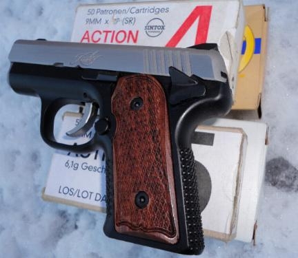

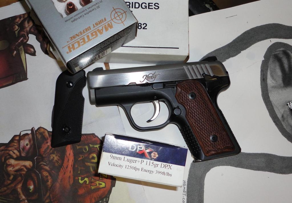

A guy who's been on my list a long time let me off kinda easy with some light work on a Kimber Solo 9mm. I'm sure most of you have seen these in the magazines lately.... I shot one earlier this year when Patrick Sweeney brought one of his test guns to a class. It shot well, felt and looked good. Made me think they were worth another look.

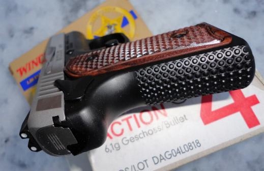

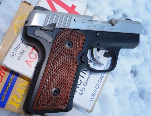

This customer sent his, with his only complaint being the bare front and backstraps, and he wanted me to look at putting Conamyds on it. The frame is aluminum, but front and back, it was plenty thick enough for any kind of pattern, so Conamyds it was. The frame had a bake-on finish with no anodizing under it, so I put the same back on it after doing the work, which also included a little further dehorning (although it was pretty nicely done from the factory), and some minor improvements to the magwell. He had also sent some nice walnut grips that I think add a lot.
The gun was originally "reverse" two-tone as seen here, but after doing a little edge-removal on the slide (again, it was not bad from the factory), I reblasted and did a quick polishing of the flats. Between this and the walnut, the gun has a whole new look. Pretty nice in fact for a gun that's going to get tucked into SWAT hard armor as a backup.
Now, do these guns work? Between Sweeney's sample and this one I've fired maybe 50-75 rounds through them.... sofar so good, and I'd like to have one, but gonna wait for some higher round-count reports. This customer though, who is a genuine shooter, seems to have shot this one enough with good results to think it is qualified for serious use.
I will say this, after having had it apart: With Kimber being so well known for using MIM parts, I didn't see any on this gun, although I was not really looking. At one point I removed every trace of lube on the gun and everything still worked very, very smoothly-- I'd say that's good design. The trigger is a light, non-resetting DA, and I like the thumb safety being there, plus it's very unobtrusive. Efforts on it are appropriate for its small size. The mag catch is ambi which I don't really care about one way or the other..... mags look very high quality. The basic layout is great, ergos-wise. Bore axis is low, grip angle is right, sights are sized right for concealability but are effective in sight picture. Night sights are not yet available and I'm wondering if some miniature Shield Drivers might be in this gun's future :wink:

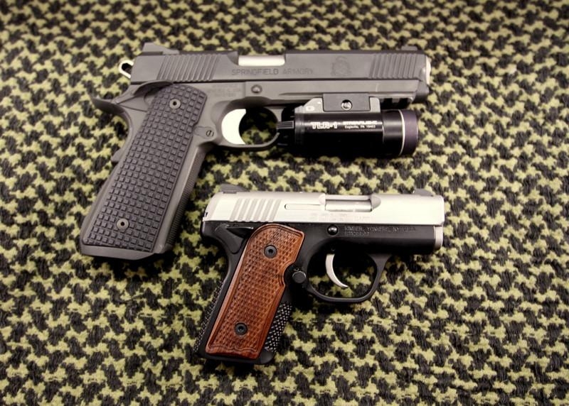

PostPosted: Sat Dec 17, 2011 1:24 pm
Posts: 4426
The owner of this Solo sent me a pic of it next to an Operator I did for him a good 8 years ago. This pic somehow is not really showing how small the Solo is.

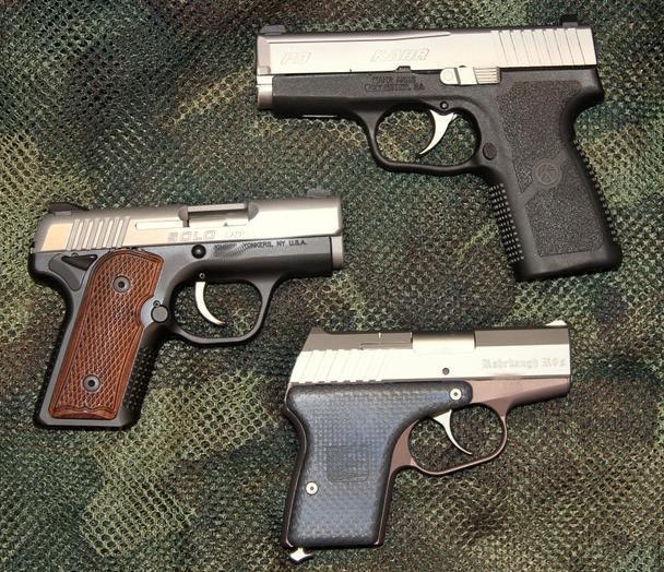

PostPosted: Mon Dec 19, 2011 7:23 am
Posts: 4426
And, one more, to show size comparison with a Kahr PM and a Rorbaugh.....
PostPosted: Mon Dec 19, 2011 9:52 am
So...Solo or R9???
