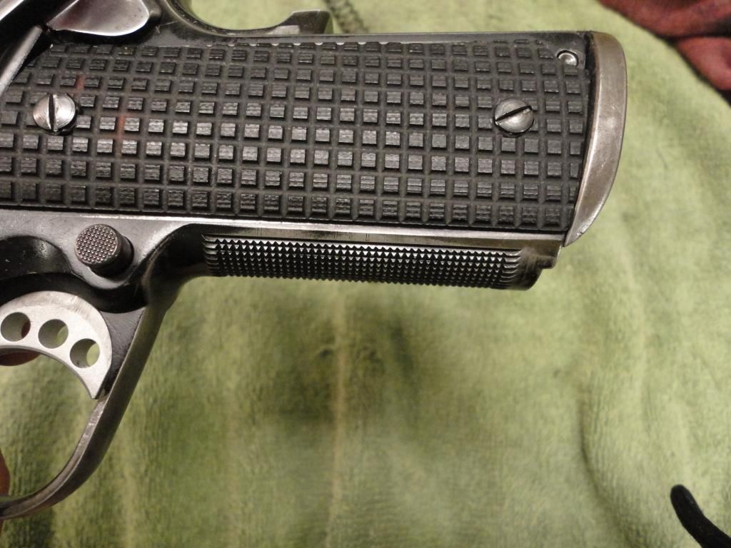

The frontstrap checkering has taken a bit of a beating……

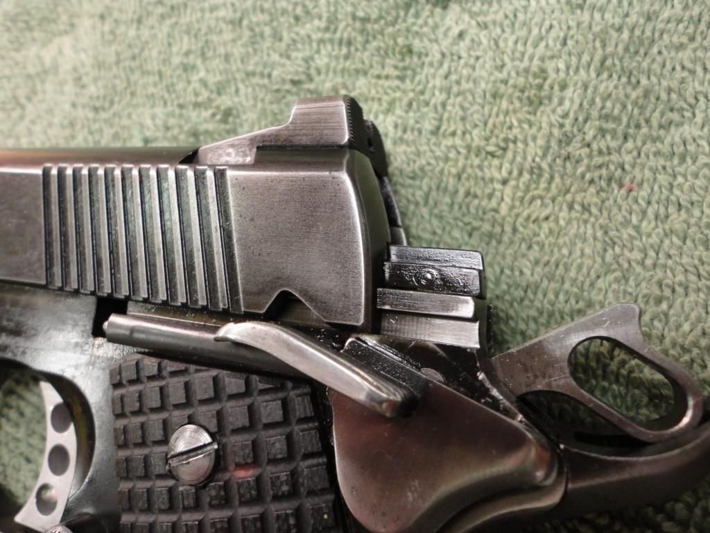

Overall right side. One version of my Shield Driver sight, made from a Yost Professional, before I started making them from scratch to my mid-eighties design. All other bits are stock Springfield except hammer and sear, plus the slide stop is not stock but neither of us remembers changing it. I believe the S&A magwell was stock on this but not sure.
Even the original MIM ejector is still there. I must say this Springfield has held up exceptionally well. The frame rail cracked above the slide stop window—common and no big deal….. that’s all there is for cracks.

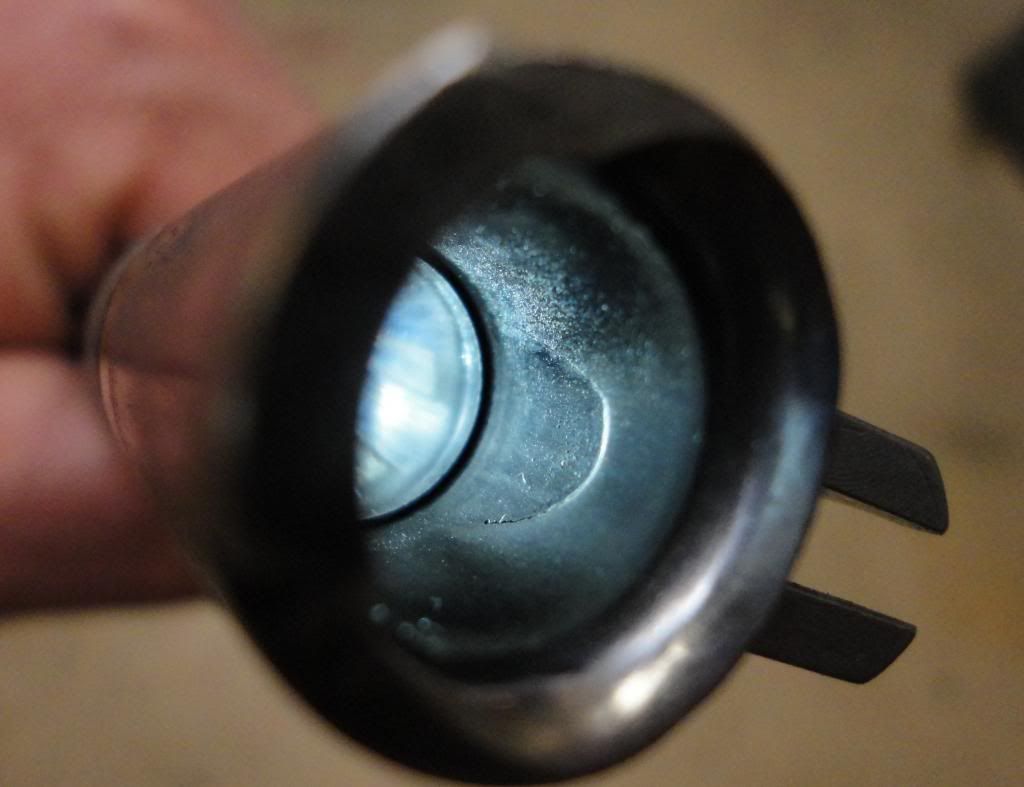

The breech face—not as worn and dimpled as I would expect with this round count, regardless of the loads used.

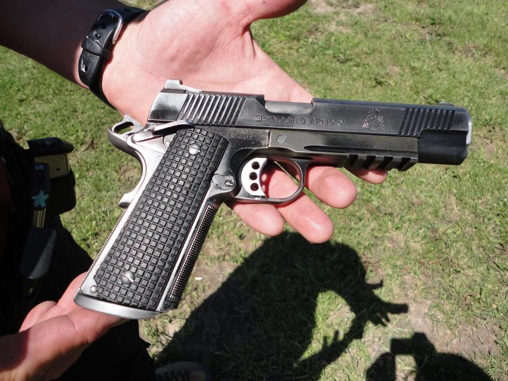

Real sorry we lost the pics, but I was with Rob again this week at a class and snapped a few. He keeps accurate round counts and says he's now at 82K plus or minus 1500. Only 6000 +/- 1500 of those were jacketed (stats corrected from 80K and 2500 on 7/8/13. from notes taken at said class).
I'll just say this, I have no doubts whatsoever as to his round count. He is very meticulous about that kind of thing.
Could not get great pics in the bright sun as I could not see the screen on the back of the camera. I lament the passing of a regular old viewfinder on these dang things.
We chatted while shooting together at 300 meter pop-ups. Now that's what I call interesting conversation. Neither of us connected though.
The black / green coloring is due to the fact that it came from SA in OD green Armorycoat. When I worked on it I just shot black over the bare frontstrap and the rest of it as opposed to making it a complete re-finish. So in some spots the black has worn through to the green..... we figured the black Backing Laquer might not get the most optimal adhesion going over the already-used and oiled green; I dried it off the best I could and went for it. Good 'nuff in this case, a high-use and well-maintained 1911.

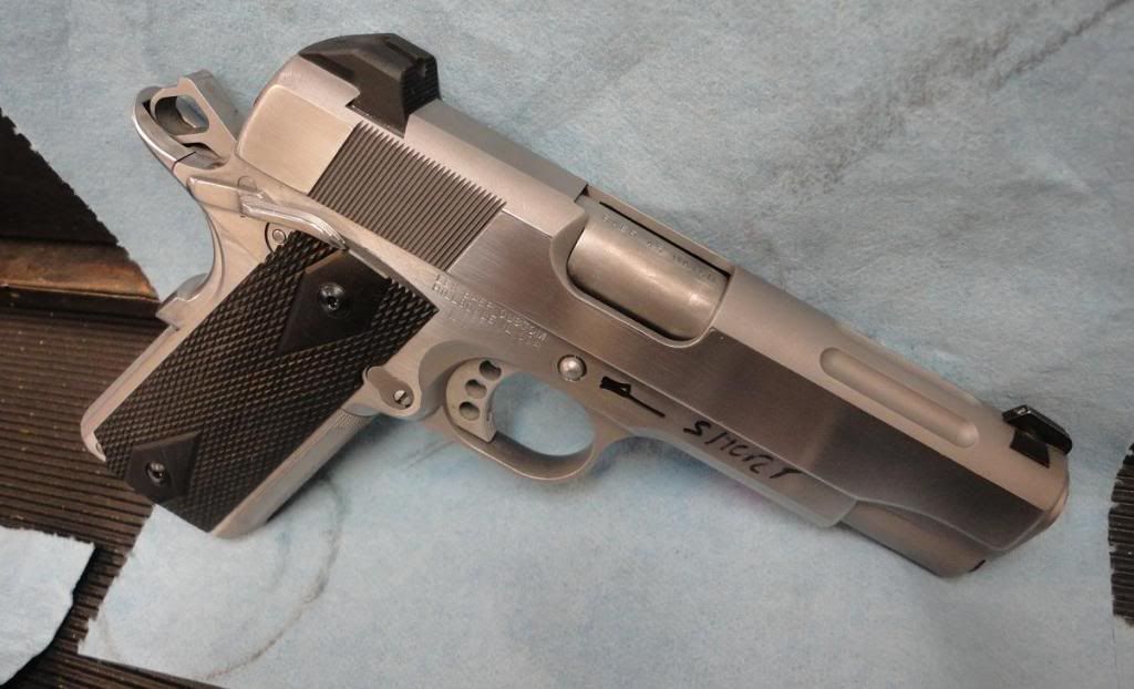

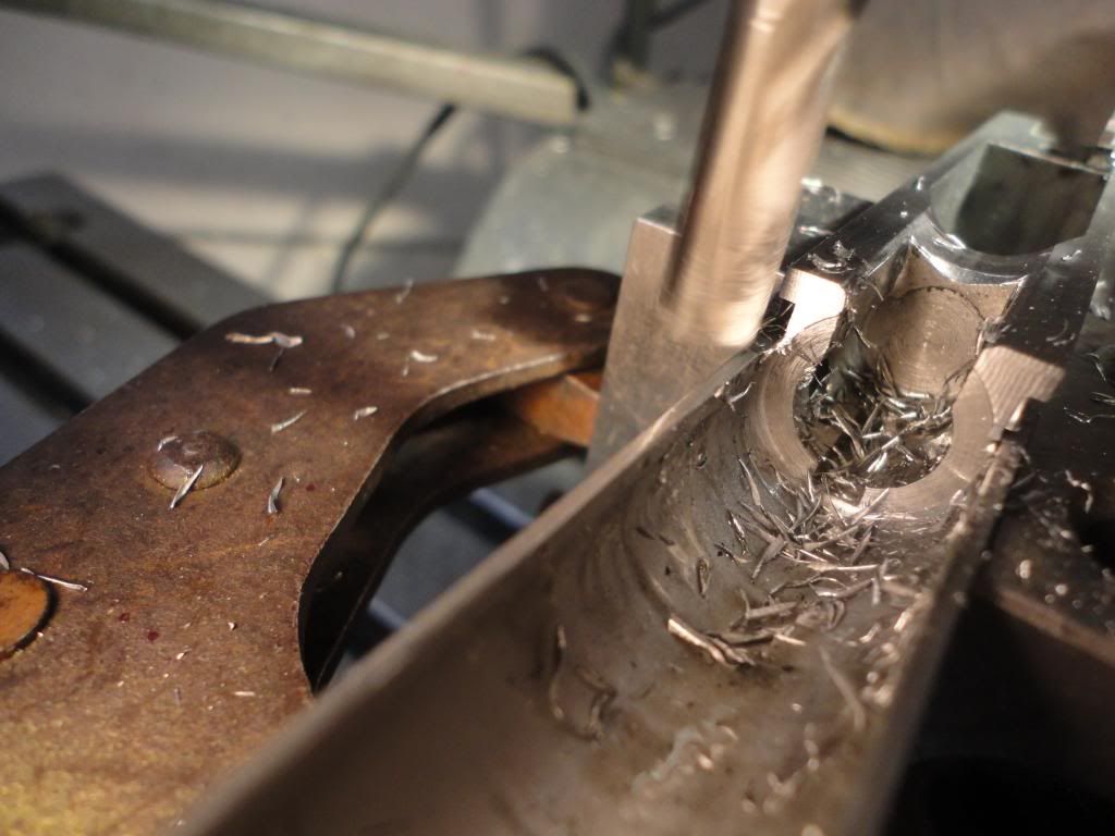

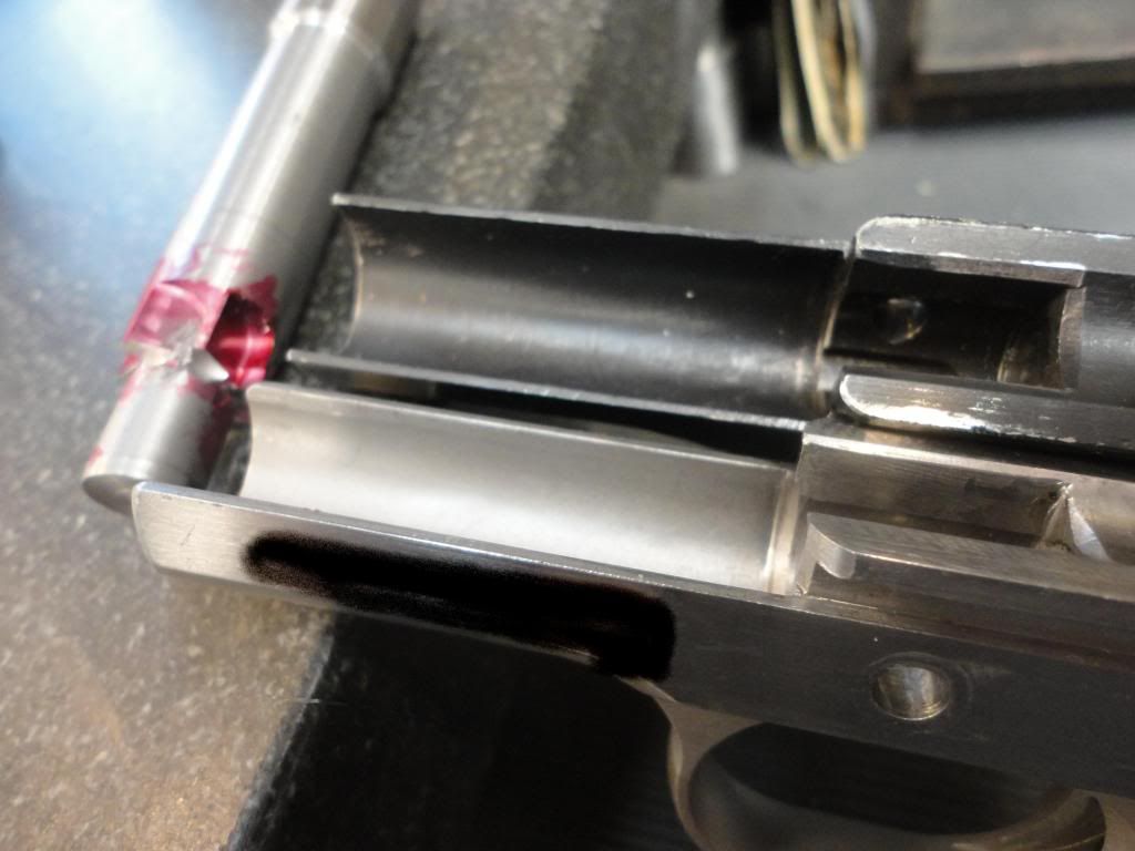

Rob's carry gun. A Commander-length originally made on a frame made from a Gov't frame..... this just is not optimal. We fixed it some time back and added the rear sight, the name for which came from a conversation with Rob who at the time was the shield driver for his team.
Top pic shows the frame dif where the recoil spring guide and slide bottom out. This shortens the stroke.
Fixing it:
Overall. Only thing left is to shorten the slide stop shaft as Rob prefers.

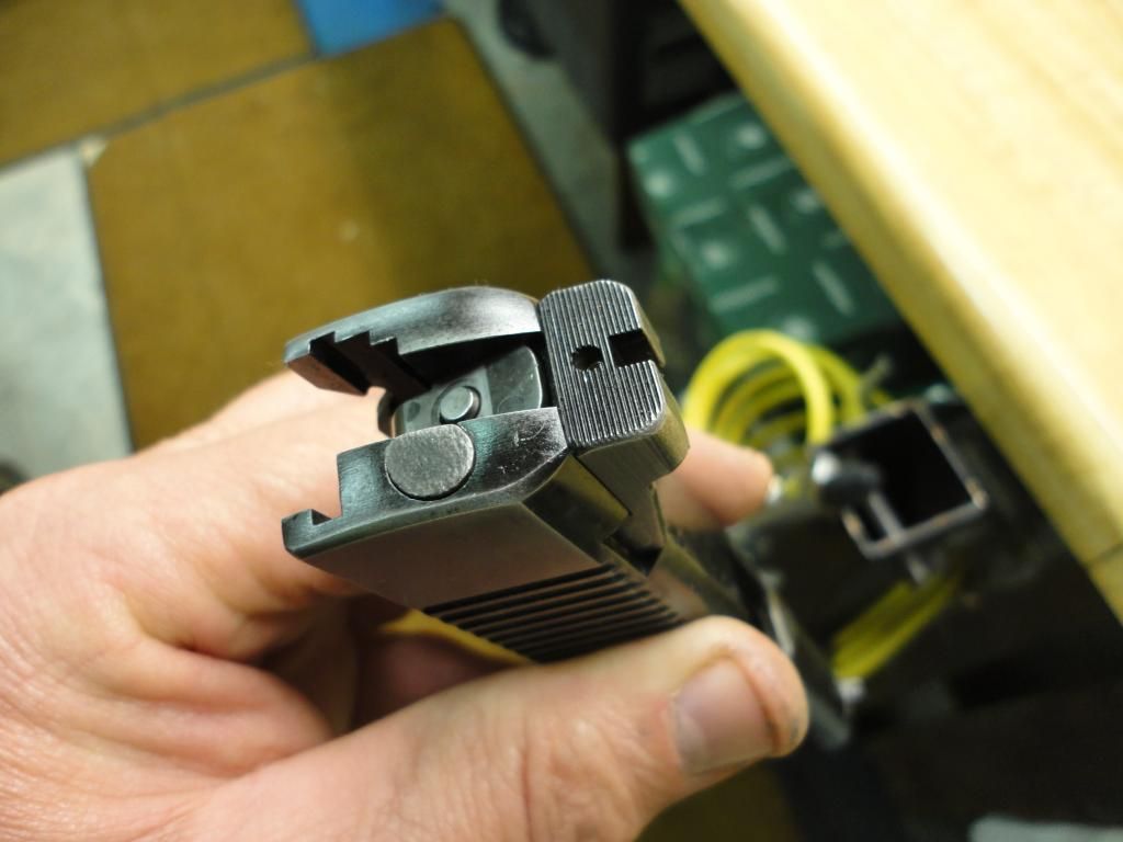

Rob came for a visit today.
The Operator is at 88,000 rounds now. Probably would have been more but he's in a new situation and the shooting has had to be curtailed somewhat.

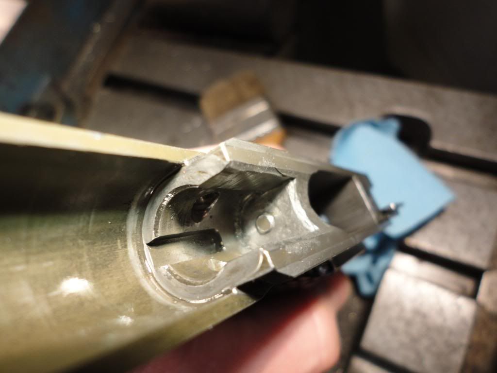

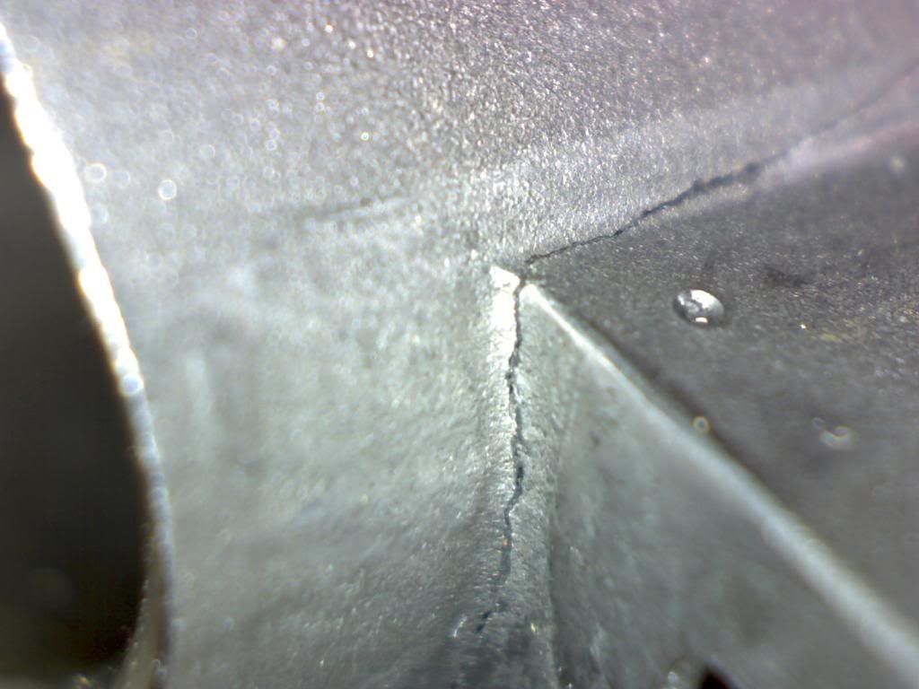

We were looking at another project and I asked if he brought the Operator..... he did. I proceeded to take it apart just to see if there was anything picture-worth. Boy, was there. Glad I had a chance to look into it in detail-- this might have been discovered the hard way.
More later, but this is not the fault of the barrel.

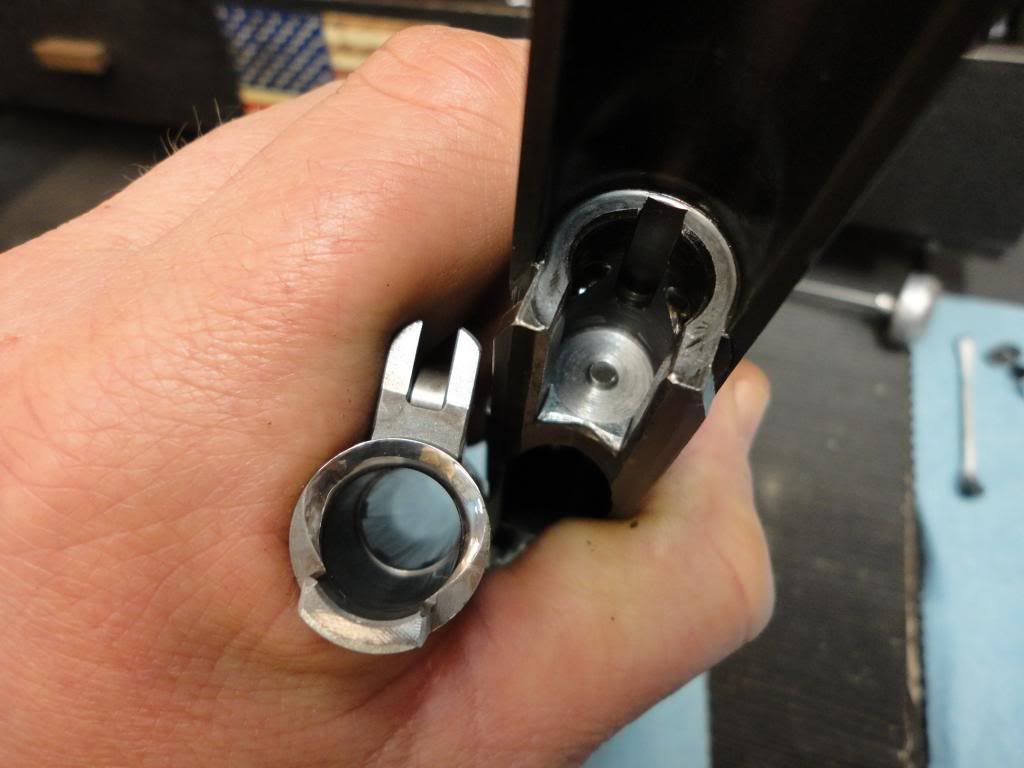

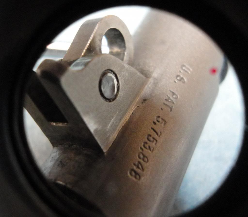

So, why did this happen?
Let's define the part hanging down under the barrel, that has the link in it, as the barrel foot. That's generally what it's called.
The rear, vertical surface of it impacts the frame every time the pistol is fired.... every pistol design has some version of this-- something to stop the rearward movement of the barrel.
As the barrel links down it hits the vertical impact surface in the frame. If I doesn't hit it, it is the barrel link that stops the barrel and it (the link) will soon break. If this vertical impact takes place "too soon", there is probably going to be some interference in the cycle and the pistol ain't gonna work right.
But neither one is what happened here. That vertical impact surface in the frame, it is preferred to have it relieved toward the bottom so that the barrel foot impact occurs close to where the barrel foot "grows" out of the barrel body. As an alternative, sometimes you'll see the barrel foot itself with a step in it, preventing any contact toward the bottom. A great may 1911's don't have this relief and as you can see, it's hard on the barrel.
Another factor would be not having a decent fillet where the barrel foot joins the barrel body. I've seen some that were pretty sharp and they weren't breaking but it really should be there. Talking here about a small fillet like maybe .015. Usually if they have anything it's more than that like .030. This Kart barrel had it.
Now, I did not fail Rob in checking this the first time I worked on the pistol-- I made the relief cut in the frame. I know I did because the tool I use, which I made, leaves a little telltale standing nub in the center. The nub is smaller in diameter than the slot in the barrel foot that accepts the barrel link, so there's no issue leaving it there. This nub is still present in this pistol but at almost 90K rounds, the impact surface has been battered back so that the barrel was once again making contact down low. It's simple-- each impact has leverage when we have that low-end contact. When it's up high toward the barrel body, it's shear forces only and the barrel foot can take it.
As I say, many, many 1911's have this condition. Might not be a problem if the user is not shooting tens of thousands of rounds. On Rob's gun obviously this condition re-appeared gradually over 88K rounds... I just wish I'd been more diligent in checking it for him on those occasions where I have access to the pistol maybe twice a year, but I'm sure I probably glanced in there and said, yup, there's the nub, we're good.

A close-up, showing the barrel had decent root fillets.

So, to recap; you want the barrel foot (or bottom lug) to be the contact point on the frame, but you want that contact to be high up, near the chamber?
When the contact is low, down near the tips, the leverage becomes great enough to break the barrel?
And on this one, it simply peened the frame at the top, until it had set back to where it could hit the barrel foot at the tips?
I've got a barrel around here that I did that to, but found it the hard way (a week before Second Chance) when the whole foot sheared off.
PostPosted: Sat Jan 11, 2014 12:37 pm
Posts: 4448
Yes on all, and me too, the ones I've seen fail were straight shear, not a tearing-out-by-the-roots like this one.

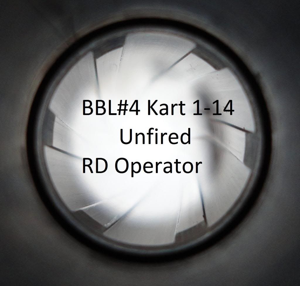

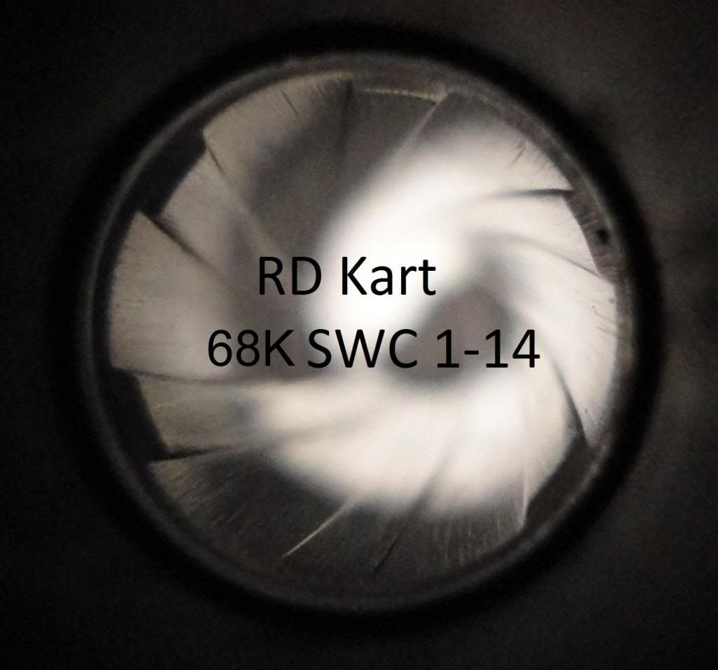

Top, the barrel that broke. I was thinking it had 38K through I but it's 68K... its good condition inside is due to he rounds in question being lead SWC loads, no sure what his load is but it feels like my 4.7 grain o Bullseye load. No wimpy, not smokin' hot.
Bottom, the new barrel unfired.

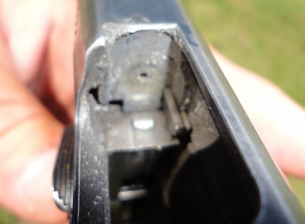

Top, bowtie cut having been made but surface pushed back from high round count, to where the bottom of the barrel foot was once again impacting.
Bottom, bowtie cut remade and a few thou filed off the lower part of the barrel foot's rear surface for added clearance / life.
I always thought the bowtie cut seemed marginal in terms of impact area but this is the first time I've seen it do this. I like the added area of just relieving the back of the barrel foot but that is removing metal in an area that is already less than beefy. Unless by EDM it's hard to get in there and make a "D"-shaped cut in the frame.
And yes, once it was back too far, you could be stopping barrel rearward movement with the link which is not good. That's a borderline theoretical problem and in this case I was still OK

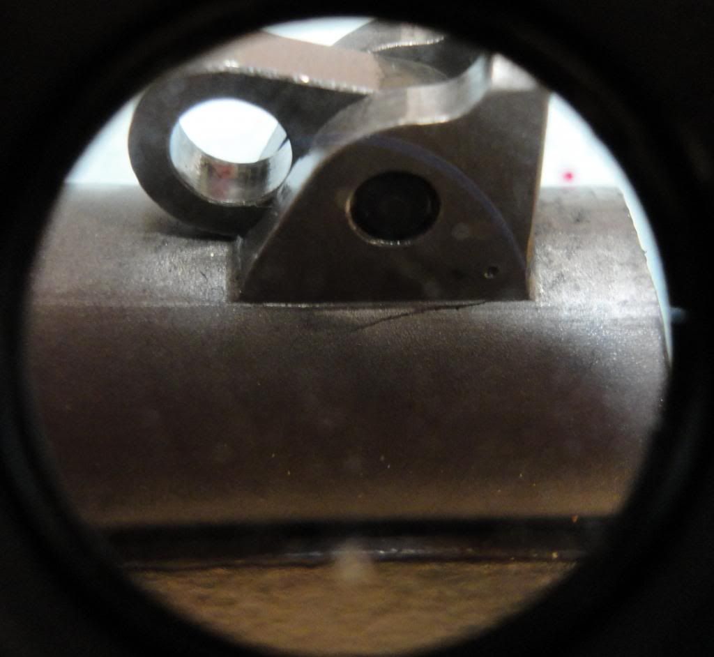

(Update 1.5.2015, now at 103,000 rounds, saw the gun the other day and the slide was cracked....)
