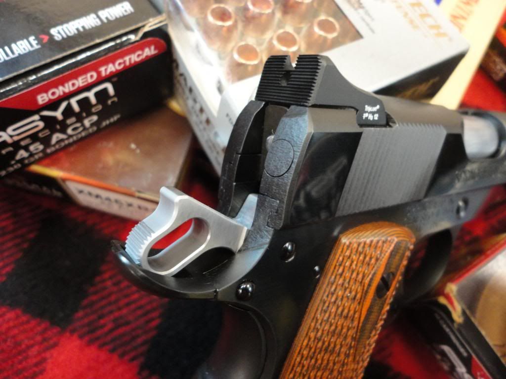

I finally got the sights back with tritium installed, so here are a few more pics.
The back end. Getting the tritium lamps installed in recessed fashion like this was the bugaboo that took so long getting it done. It’s non-standard and it always causes confusion.

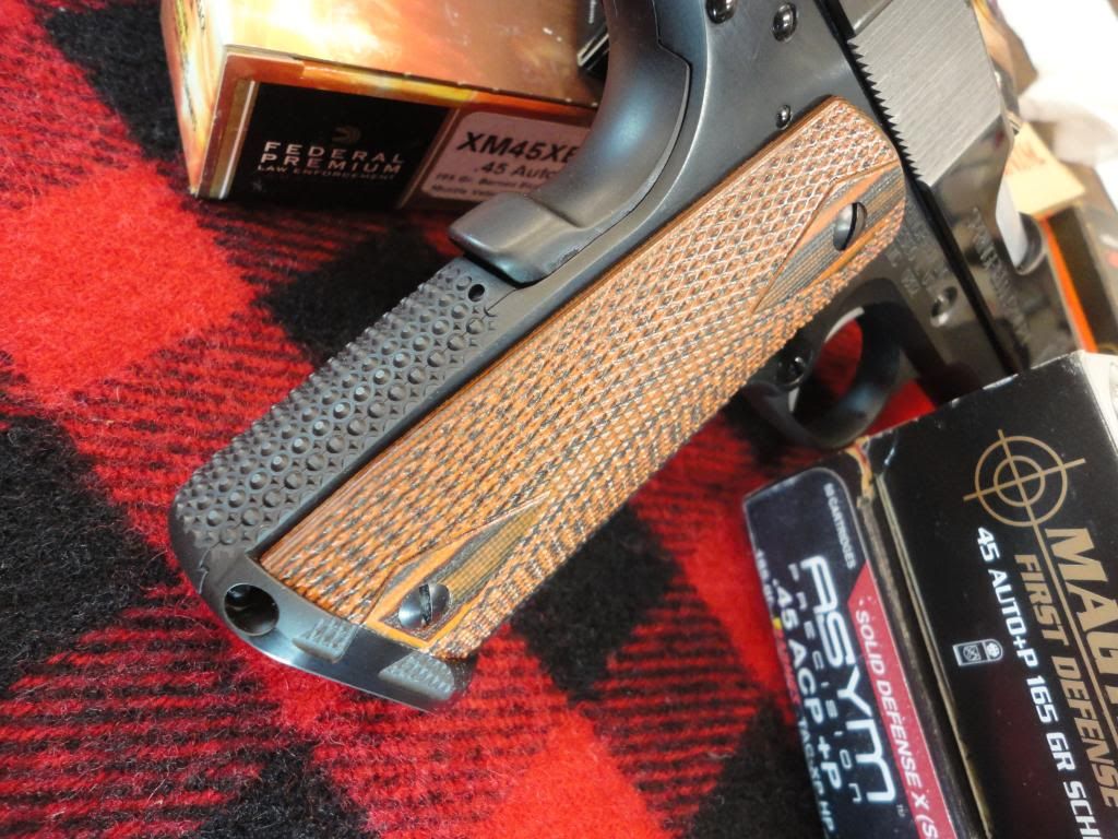

And, the backstrap. Conamyds wrap onto the frame.
