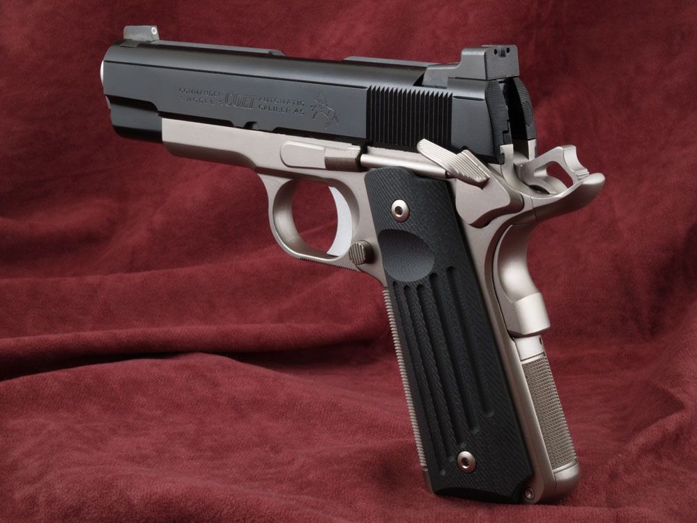

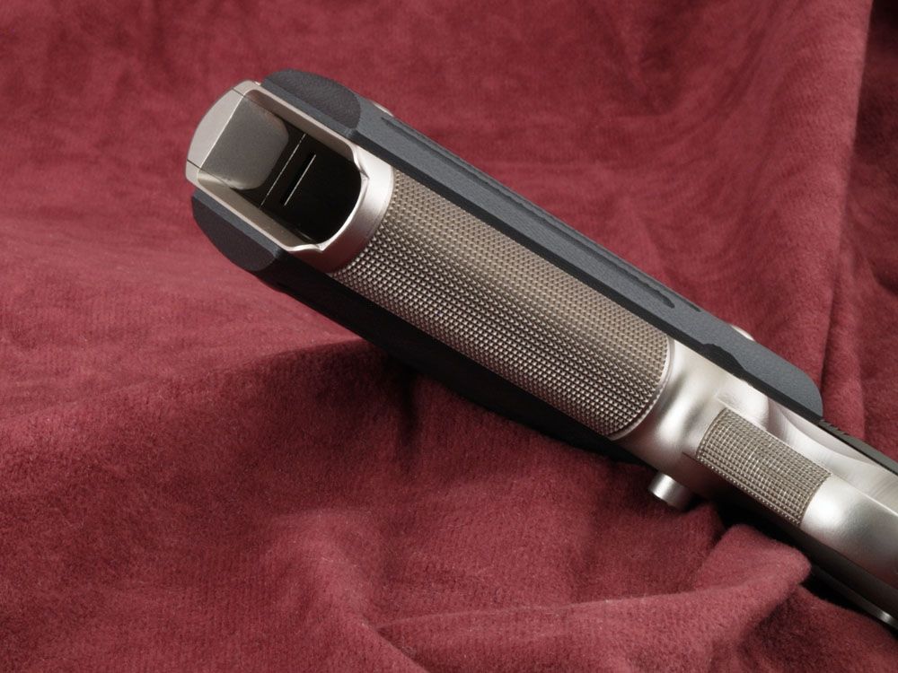

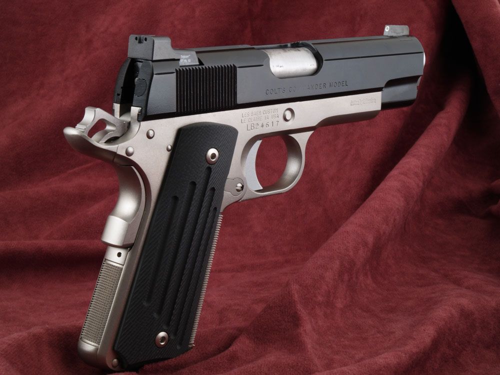

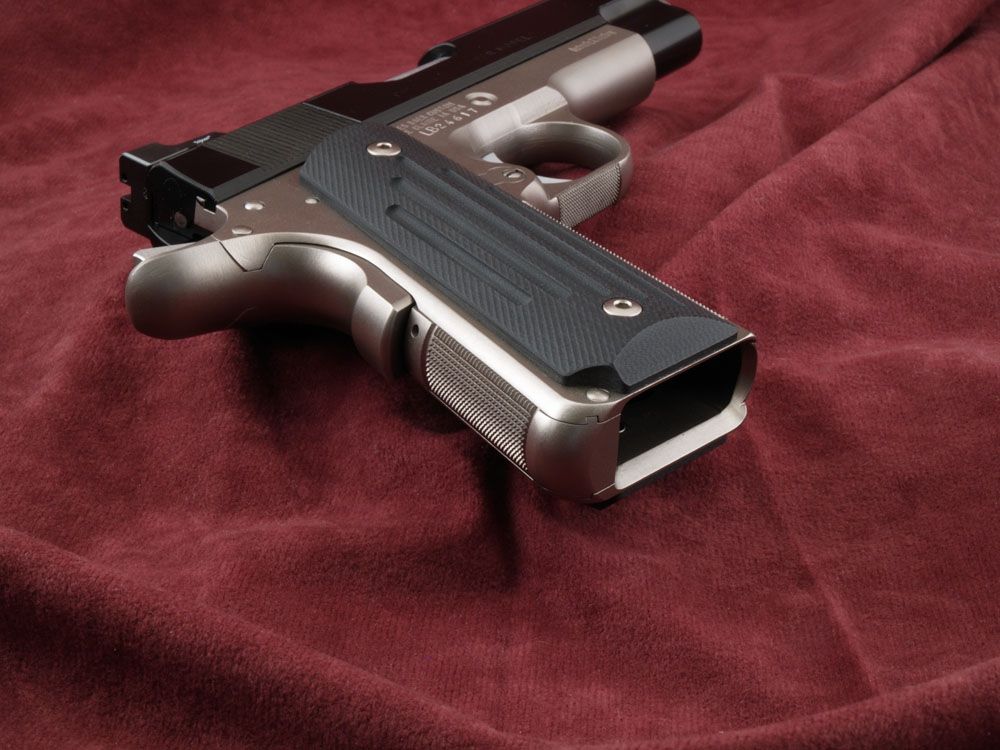

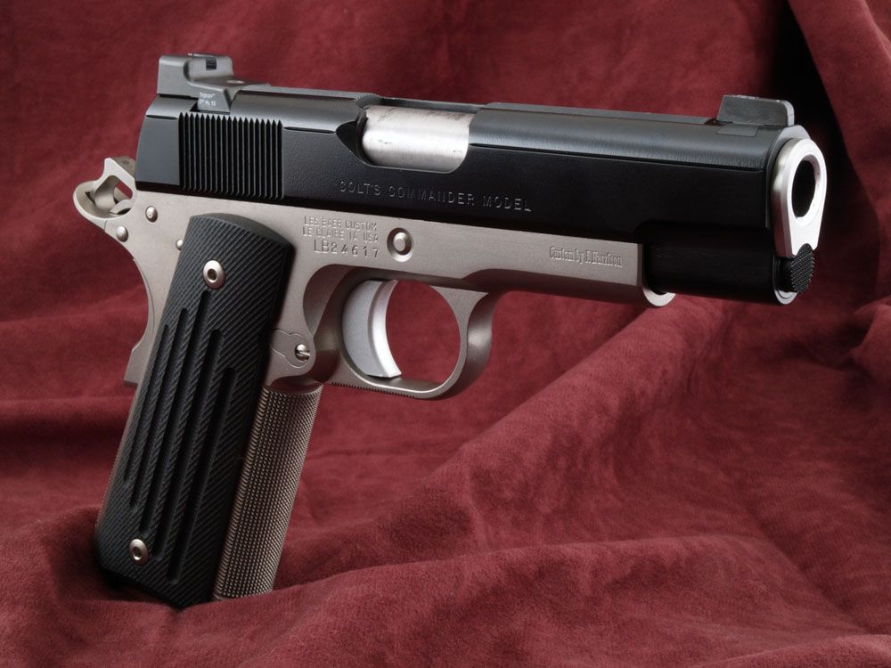

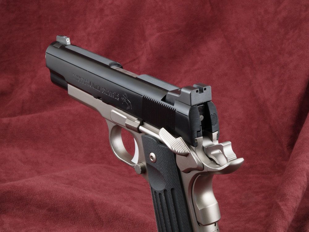

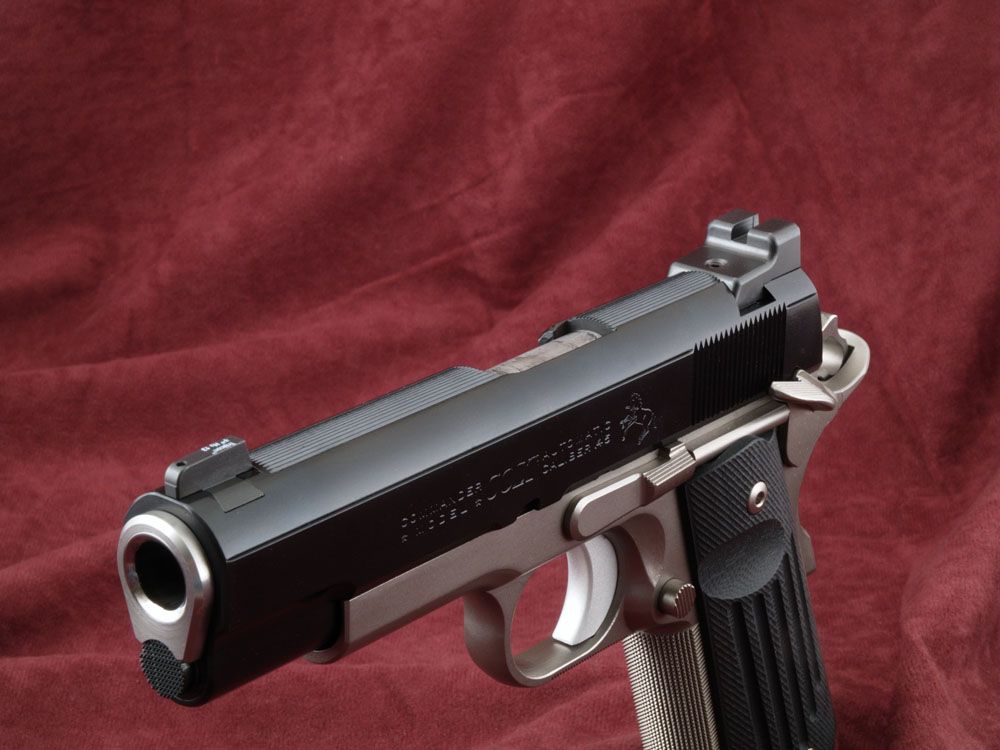

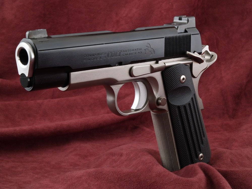

Here are some pics of a recently completed Commander built for a fellow in Federal Law enforcement. It's on a Baer frame with a nice Colt slide. I set it up with a deep polished crown Kart barrel in .45 ACP with both a H-D logo plug/bushing set and an EGW thick flange bushing with a checkered long nose EGW plug (shown here). It's wearing a set of my HD-004-T2 rear night sights for the Novak cut, a set of 30 lpi serrations leading the way to the SDM dovetail front with tritium lamp & white ring. A set of 30 lpi serrations on the rear of the slide, heavy bottom bevel, ball cuts and French borders complete the slide. The frame is high gripped and checkered 25 lpi on the front strap and Chen main spring housing and 30 lpi under the trigger guard. A 25 degree mag well bevel makes for a nice place to stuff magazines and the H-D extended mag catch locks them in place. The thumb safety and grip safety came from EGW while the hammer is from Wilson. A set of H_D Carry Groove grips and hex screws give you something to get a grip with. The finish was done by Robar. It is Np3+ on the frame assembly and black Roguard on the slide.

Cool finish choice and a quintessential carry gun. Curious, why the odd couple?
 Post subject: Re: Commander from H-D
PostPosted: Thu Apr 18, 2013 5:19 pm
The frame and slide were supplied by the customer.
