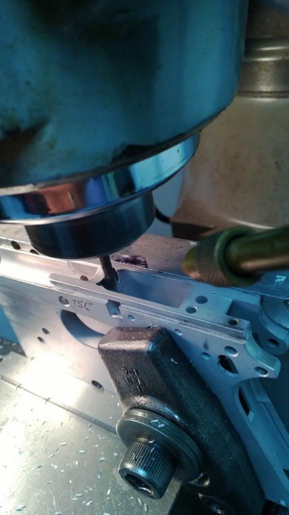

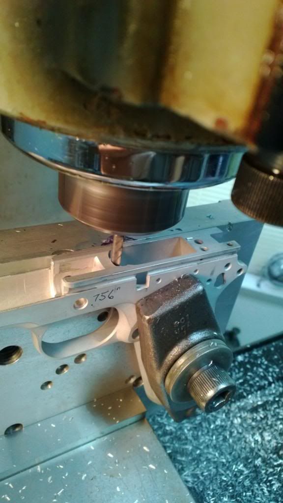

Everybody loves to take a peek at the other guy's workbench. Here are a few snaps of an old-school Commander that I'm currently building. I'd like to save this thread for this gun to watch as it comes together, but please start your own thread and show us what you've got going. Let's see what you other 'smith's are working on, warts, dust, scuffs and all!

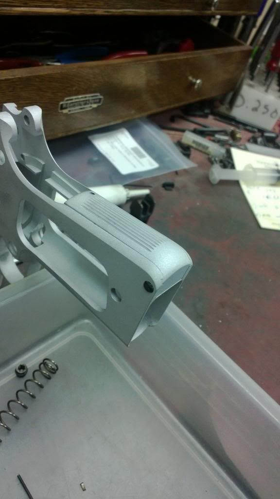

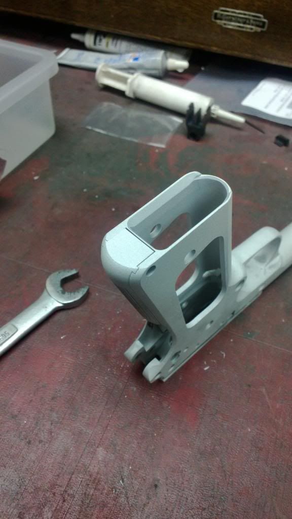

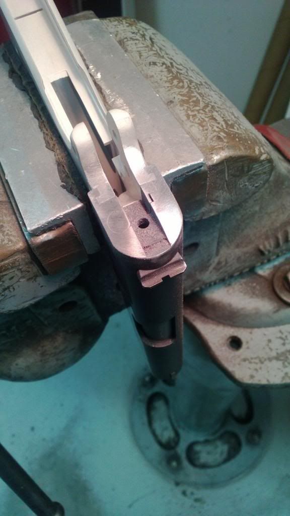

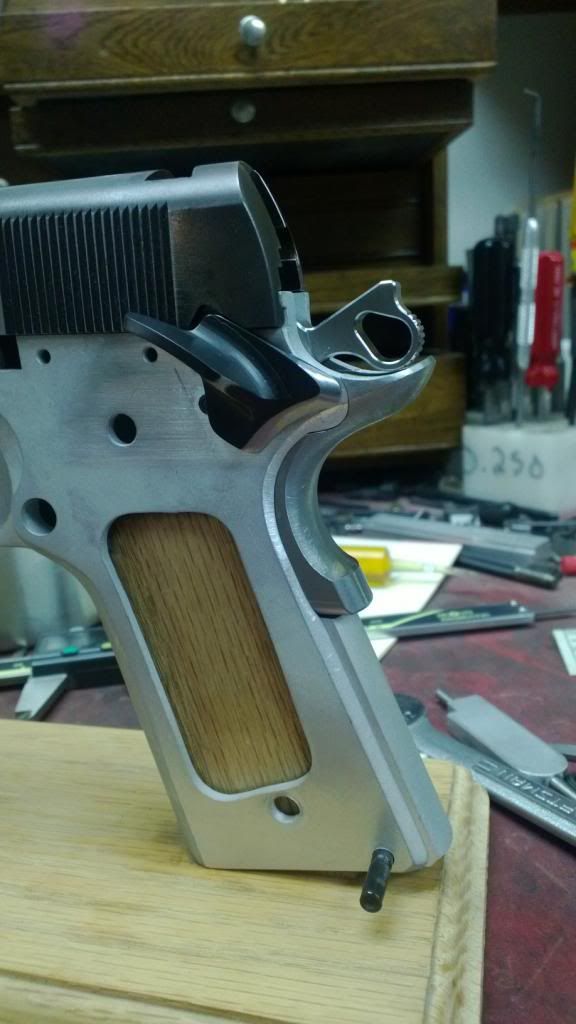

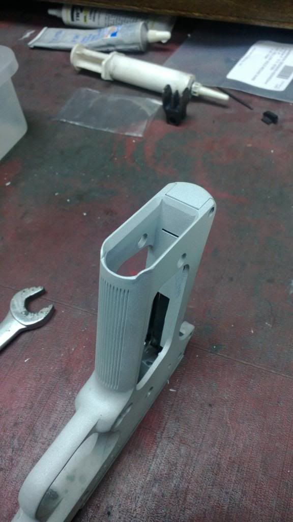

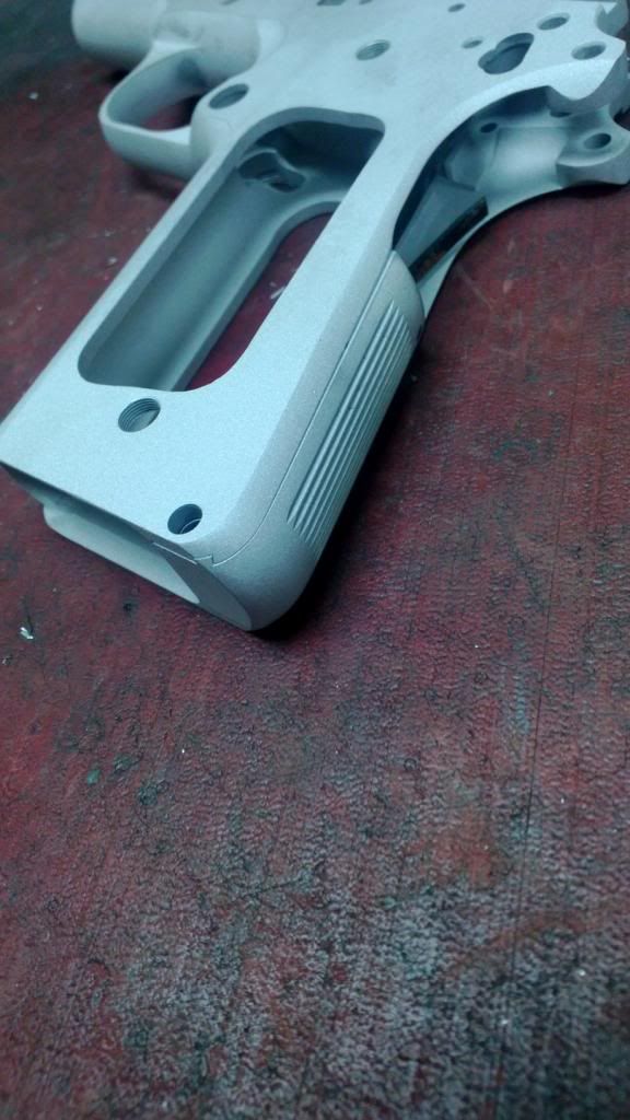

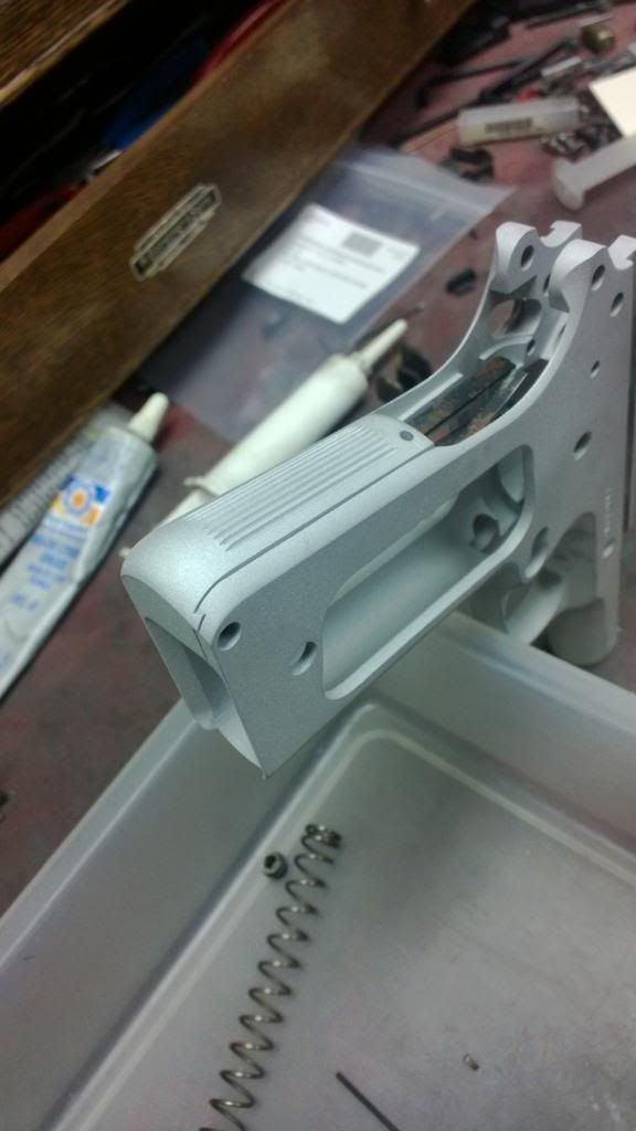

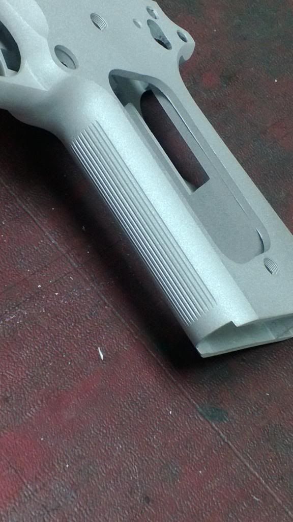

Here are some more frame-related pics showing the flat VZ aluminum MSH which I've thinned, serrated and round butted. Also shown is the mag well bevel.

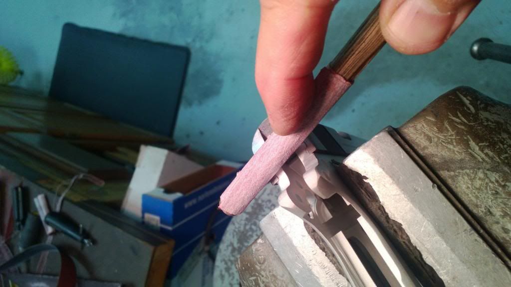

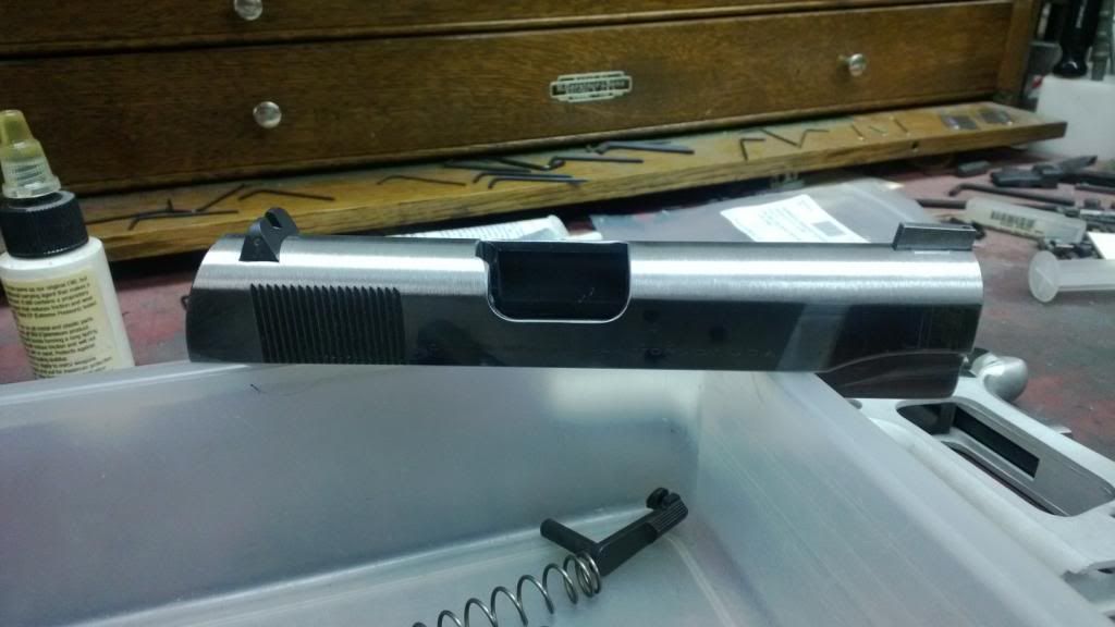

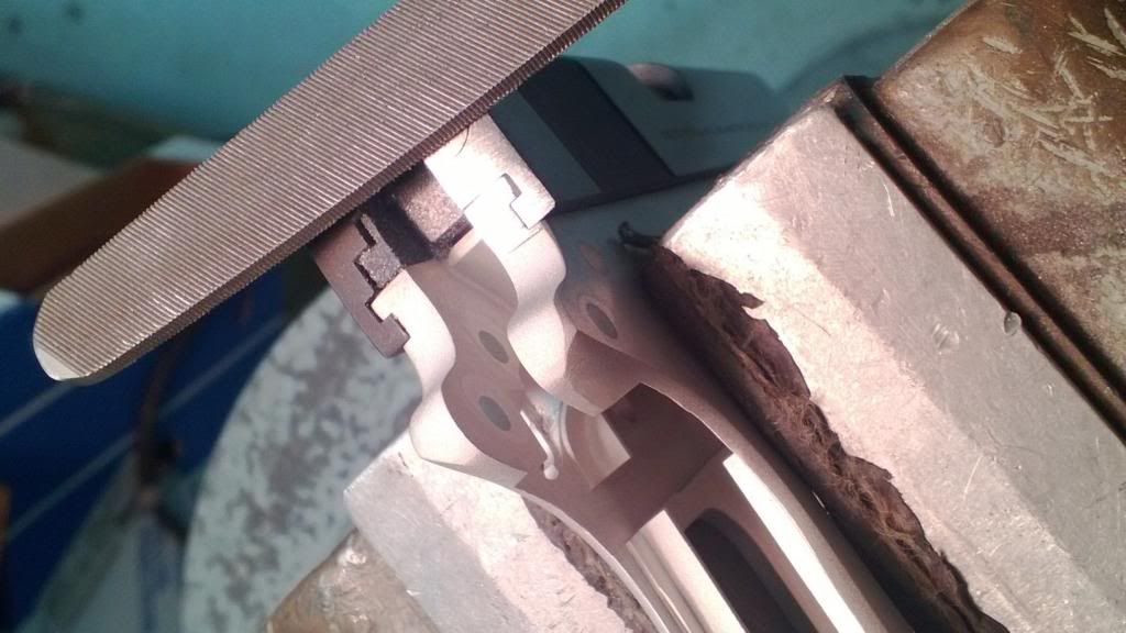

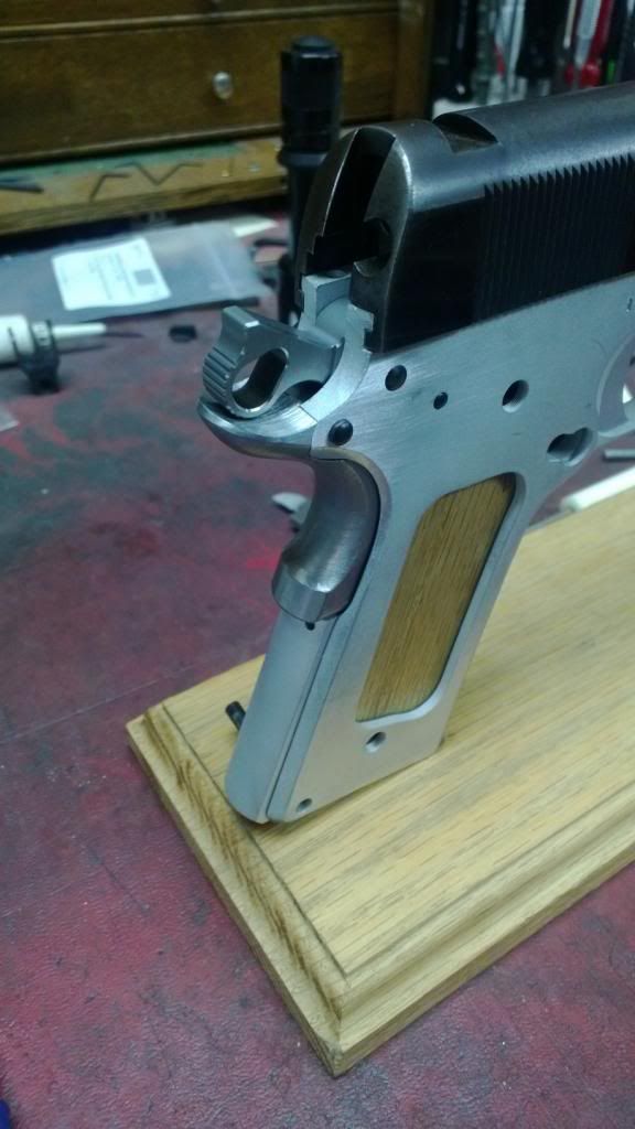

A little more progress to share. After fitting a Kart barrel, there was about .020" or so of slide overhang. So I whipped out the trusty 10" mill bastard file and rough filed it all level, then sanded out the file marks with some .150 grit paper wrapped around first, the file and later, the special Harrison-approved 3/8" hardwood dowel. Here are some pics, in order of progress.

Nothing to make a layman like me shiver more than seeing someone approach a nice Colt with a fresh mill bastard file. In the hands of a maestro, though, art appears. The entire rear of that gun, top to bottom, is just so...so...right! Makes you just WANT to pick it up!

An incredibly-helpful overview for guys who have spent years looking at build sheets and finished pistols, but who have rarely (if ever) been afforded the opportunity to peek behind the curtail while a project is in-progress. Gives you a whole new appreciation for the skill set involved when you see the set of hand files come out.
Have really gained an appreciation for these round butt treatments, as well, though it remains something of a mystery to me how this is actually realized. Doesn't really look like a simple jig operation, but given that the frame is involved, there has to be a careful method to the madness. Any bench artists care to offer a modicum of enlightenment to an appreciative shooter?

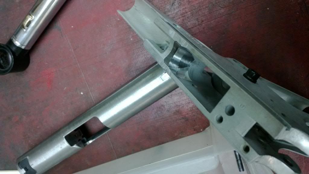

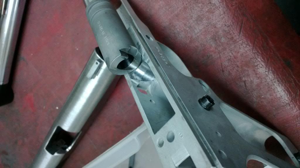

Here are some pics of the steel feed ramp insert being done.
 Post subject: Re: In Process Pix
PostPosted: Sun Aug 04, 2013 5:55 am
Now that's just plumb neat to see.

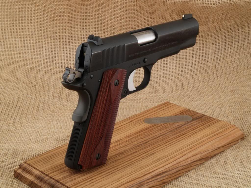

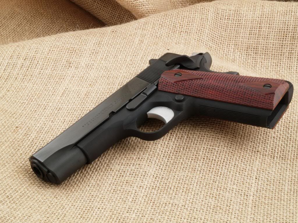

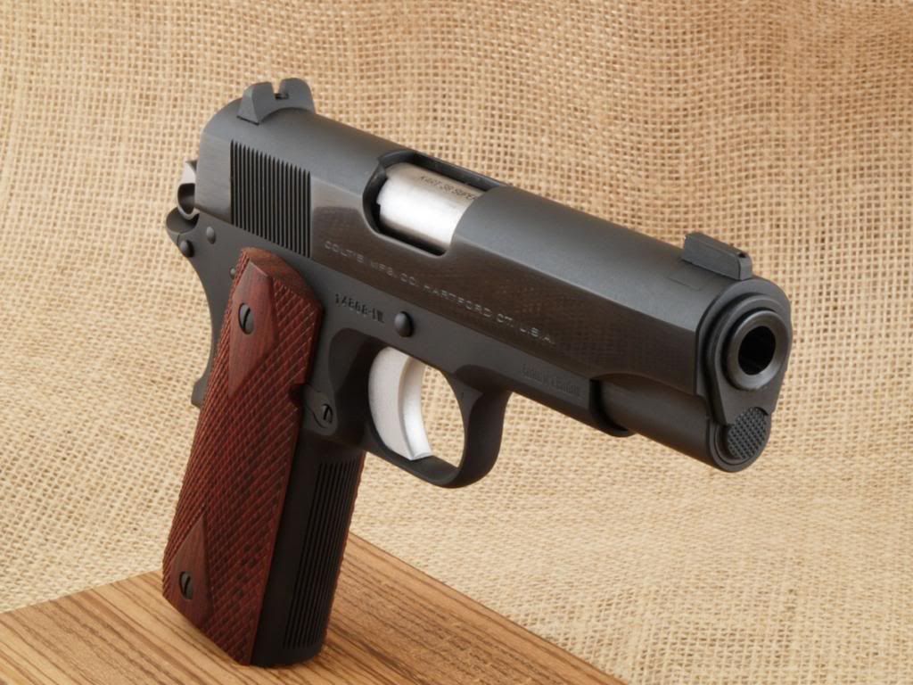

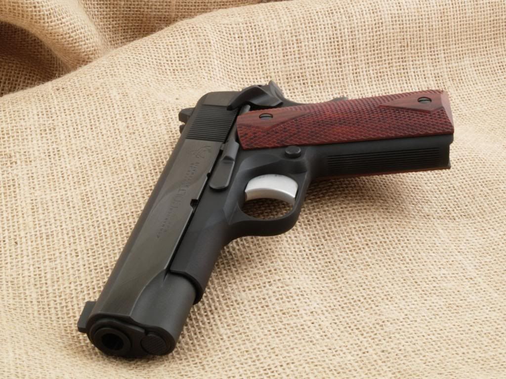

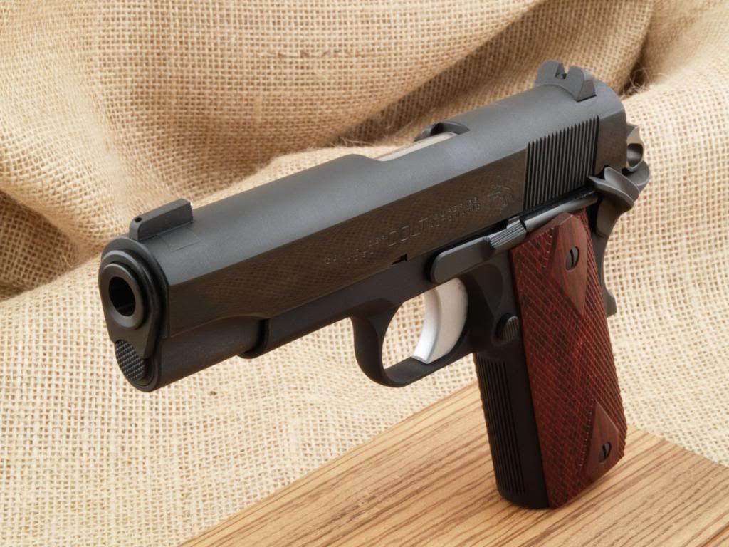

It's taken a little while to finish this one off due to in part to pieces having to go out to three different finish vendors. But, I'm liking the end results!
PostPosted: Sun Oct 27, 2013 7:01 am
A clean retro look; nice work Mr. Harrison....
PostPosted: Sun Oct 27, 2013 2:08 pm
IB, Blue, & Cera?
Nice and clean build
PostPosted: Sun Oct 27, 2013 3:57 pm
IB, Blue, & Cera?
IonBOND, Blue and Anodize

Took me a while to initially make the connection between the gun in-the-white and the finished product seen here. Quite the transformation, and the blended finishes really work well together. Where did the gun actually get IB? Small parts? On top of the anodizing, on the matte rounds? Sounds like a pretty forward-thinking approach.

Nice and clean, John.
PostPosted: Tue Oct 29, 2013 4:45 pm
OUTSTANDING ! Mr. Harrison 8)
PostPosted: Thu Oct 31, 2013 3:49 pm
Joined: Thu Nov 26, 2009 5:17 pm
Received it today, and I am very happy! I am by no means a photographer, but had to show it with another brilliant bit of custom work from Georgia..a Hossom Retribution. Thank you Mr. Harrison.
