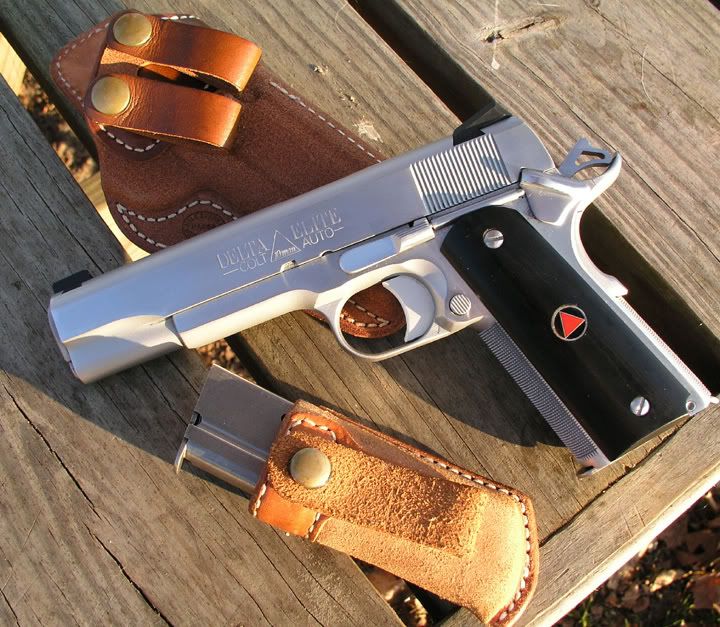

Mr. Williams built this one for me. Seven years later, still happy.
PostPosted: Mon Aug 12, 2013 6:25 am
Posts: 79
Very nice gun! Is that finish stainless or hard chrome?
PostPosted: Mon Aug 12, 2013 6:29 am
Joined: Wed Nov 10, 2004 8:38 am
Posts: 25
Location: Ocala, FL
Hard Chrome.
