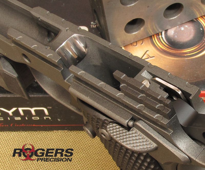

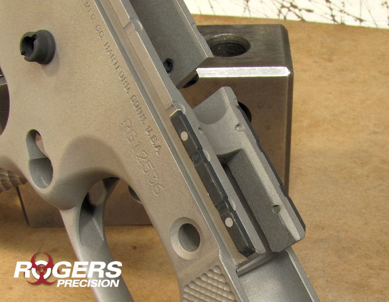

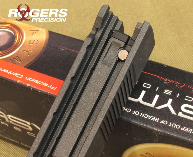

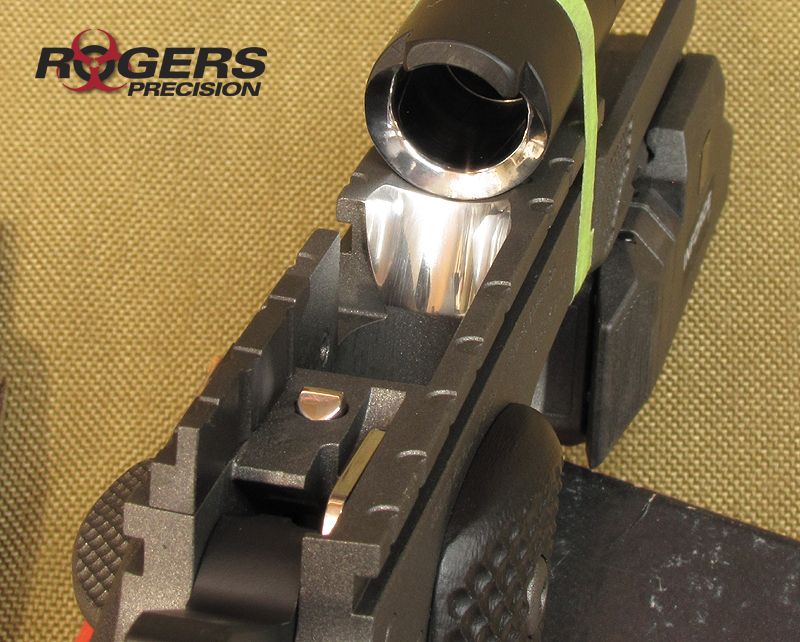

Care for a peek inside?

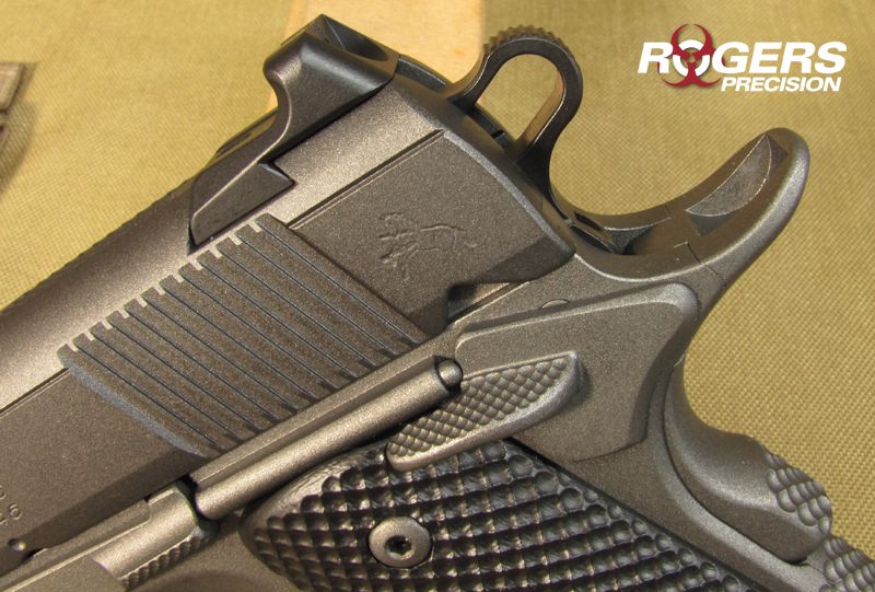

Slide and frame are stainless. To tighten, I fabricated, silver soldered and pinned 4
hardened Chrome-Moly inserts to the frame. No fear of galling.
Park bath only darkened the inserts.
Sand cuts by customer request.

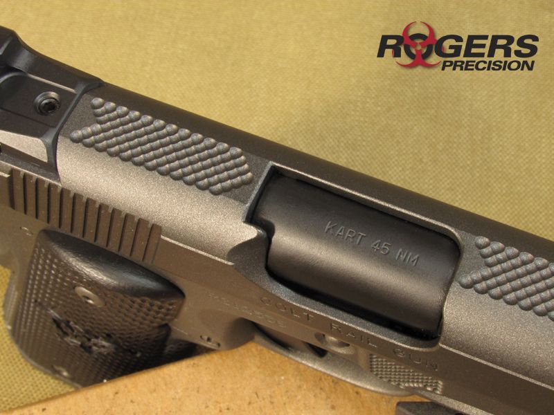

Disassembly notch detent also by request. The heavy bevel at the
bottom of the slide makes the notch difficult to see in poor light.
