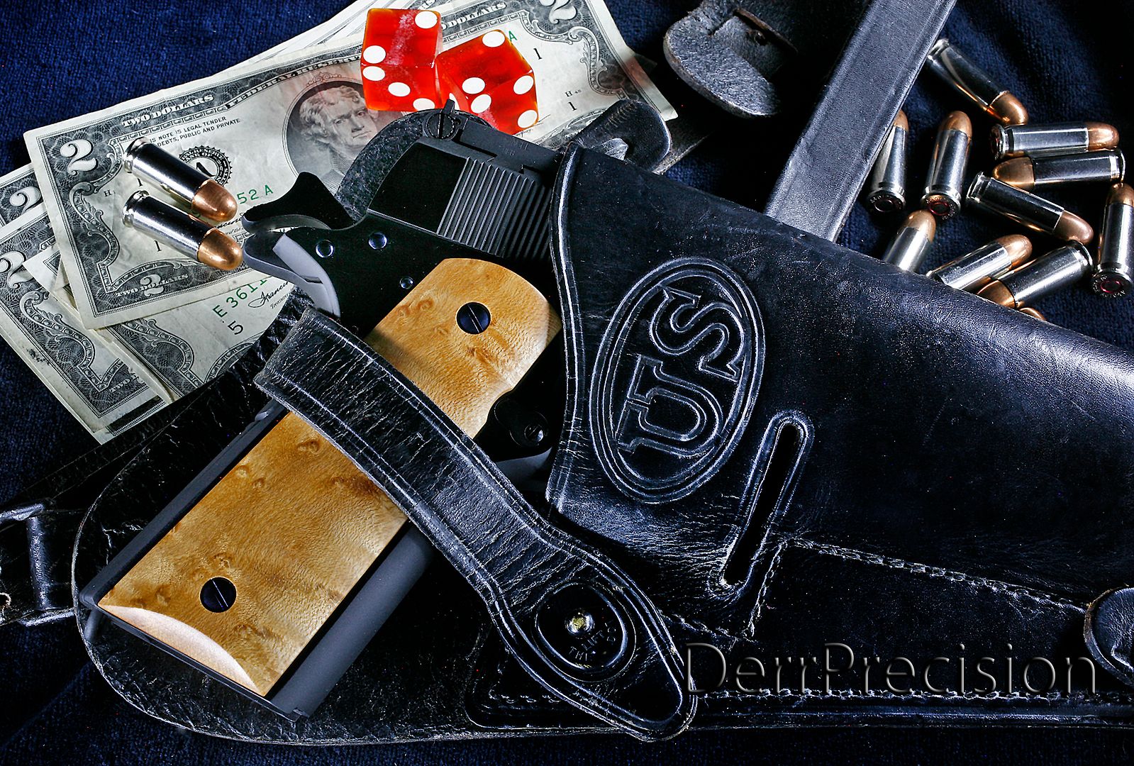

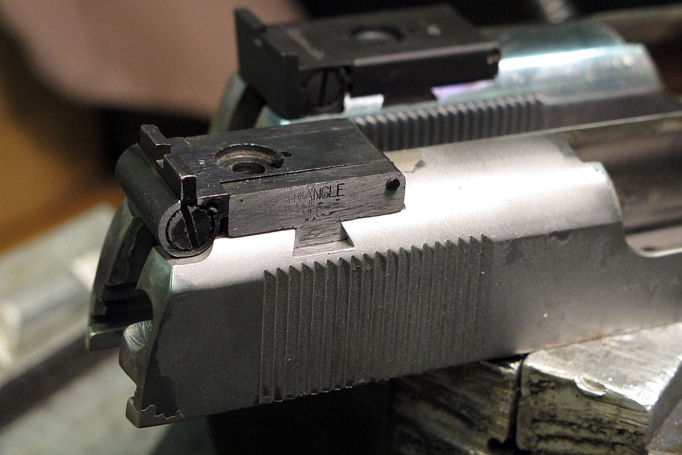

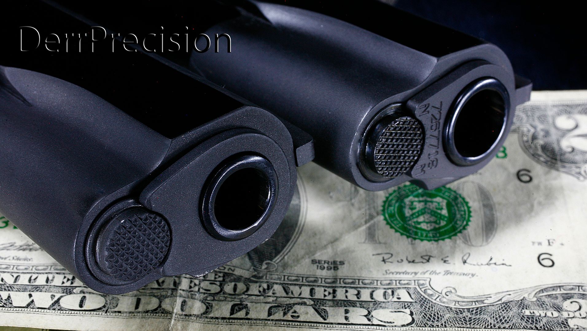

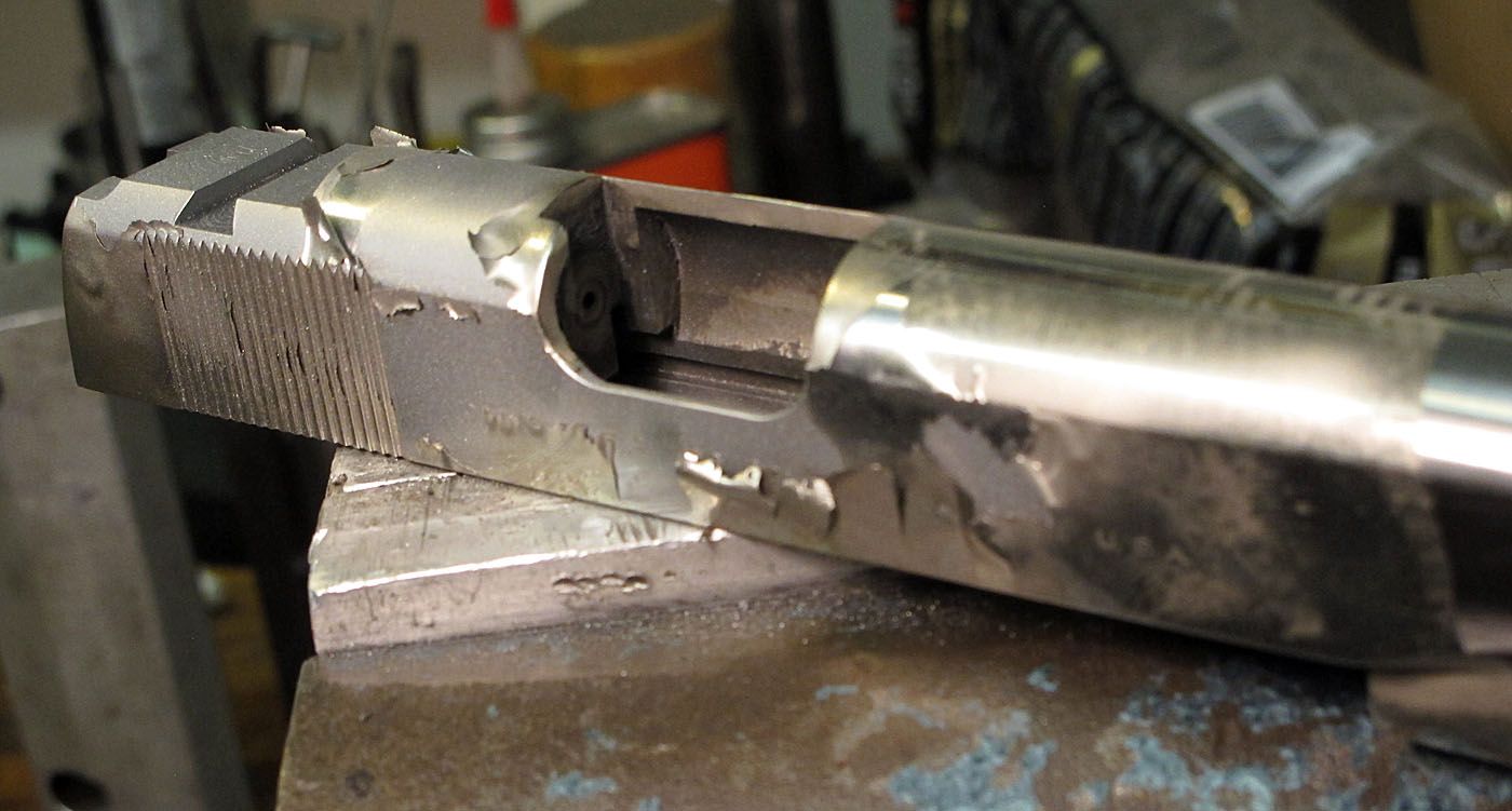

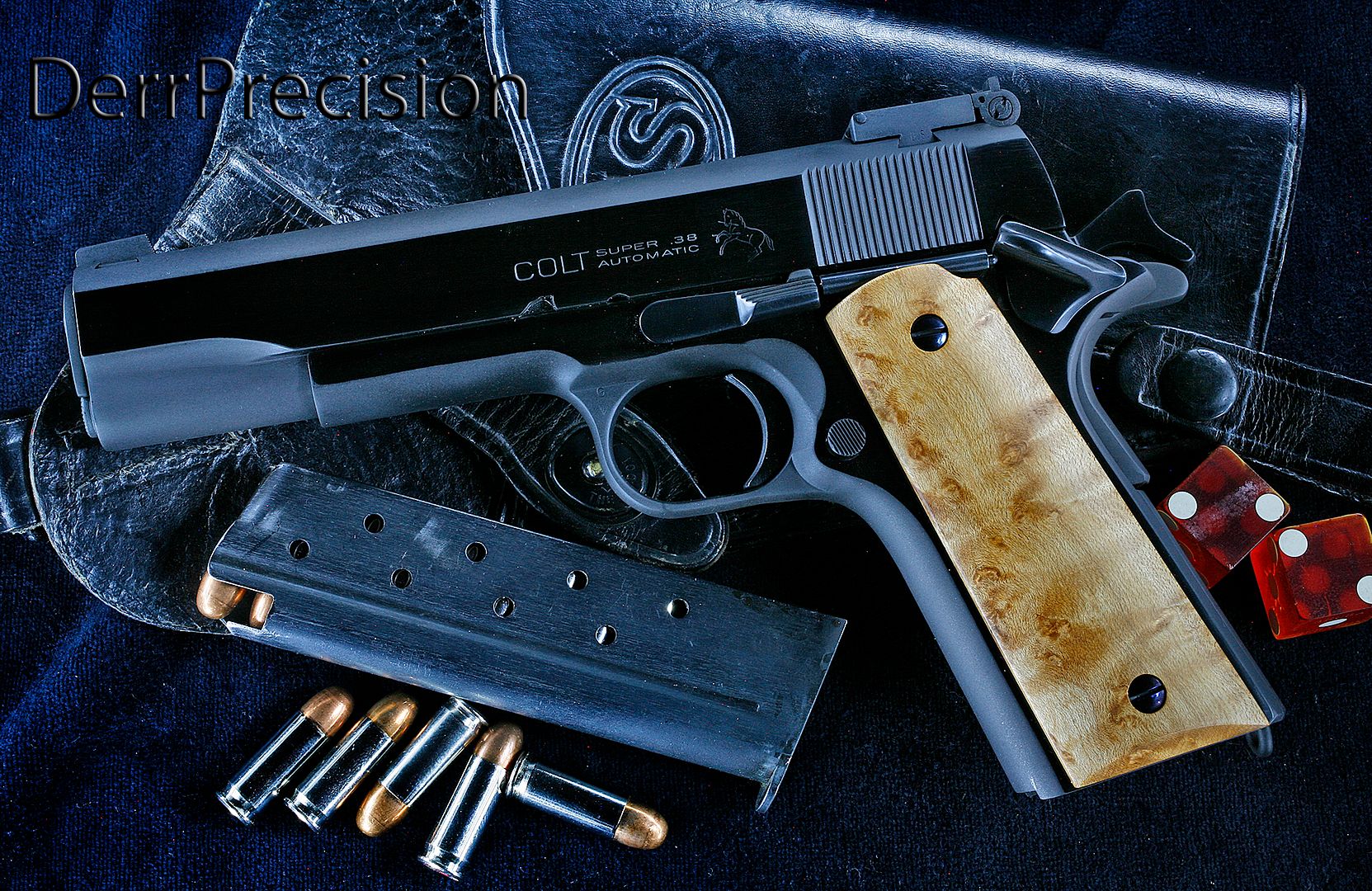

This project started out with a commercial Colt .45 of 1952 vintage. The owner also had a .38 Super top end of the same vintage. Both had been chromed, as in bumper chrome which was the thing to do long ago. My task was to make both run, and blue again on the same frame. It took a bit of work and some help to get them done right. I managed to use most of what they came with, with a few additions. The Super had a vintage Triangle sight, but is was installed on the GI dovetail which was much too high. That was set lower in the slide and a new dovetail front sight added. The .45 got a similar set up with a BoMar clone rear. I had to get the chrome commercial stripped at a local plater. The internals were up graded with some bar stock parts. The barrels got two new bushings cut for a close tolerance. The hammer is original and was surface ground to clear the slide slot. Two ejectors were cut, one for each caliber and slide. Finish is a hot blue to mimic a period Colt finish. The pins and screws were nitre blued to add a little contrast.

Greg, very nice recoup on this one. Cool that you stuck with the old Triangle.

The peeling on the before pics is incredible. Great transformation!

Amazing looking set. What wood is that used for the grips?
