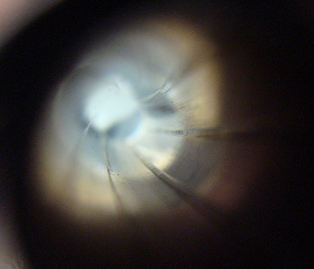

No one mentioned the odd-looking barrel bore..... notice the extremely narrow lands. It's a Scheumann "AET" which means it also has a fluted chamber and.... a gain twist:

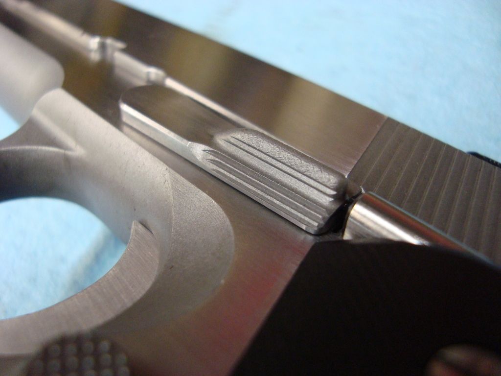

One part I'm not fond of in terms of ergonomics is their Bullet Proof slide stop. This was my attempt to make it a little more user-friendly on the bottom side.
