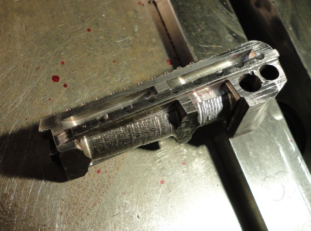

Just a couple things I've done on a recent project to get a little weight out.
Very little, to be honest-- but if you take a little out of a lot of places, eventually you get enough out to notice.
There's a lot of metal on an MSH that really doesn't need to be there:
Image[/QUOTE]
Even the rear sight is not immune:

I have to admit, it took me a minute to figure out what in the heck that thing was! I bet it took a little bit of head scratchin' to figure out how much metal not to take.

You mill and mill and mill until there's nothing but chips and then weld some of them back together :shock:

I find this exercise interesting, but really can't figure the reason why the owner/end user thinks an ounce or two will make any difference.
Just because you can, doesn't mean you should. Kind of reminds me of the guys who want an M4 profile barrel on their AR carbine, as opposed to the HBAR. Just do a few more pushups.... :lol:
No good deed goes unpunished.
PostPosted: Sat Aug 22, 2015 5:39 pm
Posts: 4430
That is one way of looking at it. My brother used to scoff at some of the measures guys would go to in motorcycle roadracing to take weight out-- even turning fork sliders down. Now that was a small return because when your whittling out aluminum already 1/3 the weight of steel...... he always said, "just visit the head before getting on the bike".
And yet, like I say of you can get 4 oz. out of it, that's going on 10%..... I won't know what I have got out of this one until it's all done but I can say that comparing this MSH to one unmachined there's quite a dif just hefting by hand. But yeah, that dif would be hard to perceive in an assembled gun.

Very nice work there Ned! Did you weigh the entire project before you started?
DerrPrecision.com
PostPosted: Fri Aug 28, 2015 3:05 pm
Posts: 4430
No I didn't. I will get some weights before I ship though!
