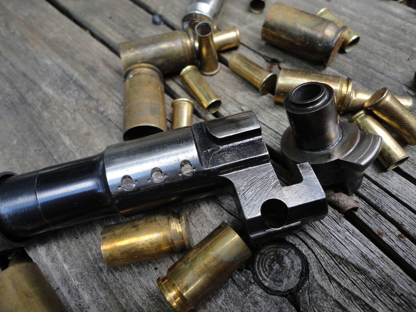

This .22 rimfire 1911 that I did for a friend a few years back has been…. well, a pain. It just never worked. The floating chamber would lead-up in 5-8 rounds rendering the gun inoperable. We talked about it and Fil said he’d work with it on ammo selection, etc. I could not bring myself to believe that none of them ever worked and yet—there was nothing really evidently wrong with this one, although it was the only one I’d ever worked with. I thought the jump from the floating chamber to the barrel should have a revolver-like forcing cone, but it didn’t…. still I thought, it’s a Colt, they’ve made these by the train load and as far as I know they don’t have a rep for not working. We’re missing something.
Recently, a few years later, I visited Fil and the gun and…. it was still not working. I took it back and looked it over. I gave it that forcing cone—I went 4 degrees to .228 diameter, then 1 degree leade.
Halelujah, it works! First sixty rounds and no leading, cycle is brisker and lockback with six different loads is positive (it was intended and touted to recoil like a .45).
.22 bbl with floating chamber. In battery, it is forward. Upon firing, the rear piece becomes, essentially, a gas piston and cycles the slide positively even though it is not lighter than a standard .45 slide.
Floating chamber detail.

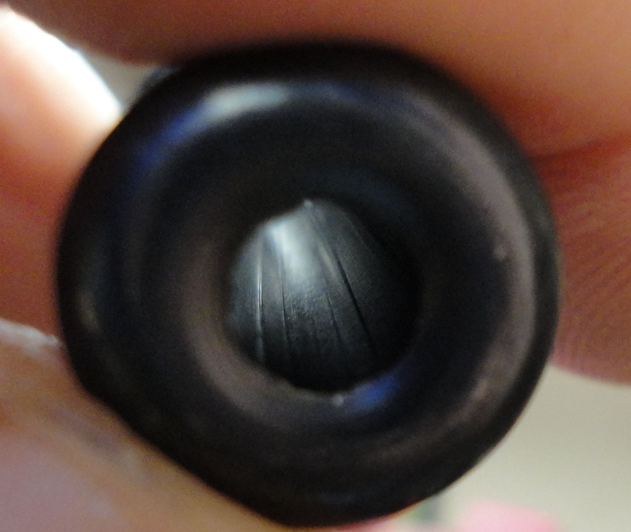

....and, the "why" of sleeving it. The original barrel inside:
The result of sleeving it with the Suhl barrel-- dang thing was more perfect than any rimfire barrel I've seen:
...and quite a bit more accurate than I thought. Worked with it quite a bit more today and with a wide variety of high-pie target ammo.
It prefers Aguila and Winchester, hallelujah. Still probably not a Camp Perry contender but much better than the original Colt barrel. And is cycles very briskly like it's supposed to, I almost thing it would cycle with shorts.

Old barrel reamed 3/8..... passes a .3752 pin but not a .376. I turned the sleeve to about .3755. It had a "head" on it so pressing it in from the front it stopped at the right depth. I put the sleeve in the freezer and warmed the barrel which made for a just-right fit, tapping it in with a lead ball. Then it has the three 3/32 cross-pins that are about .045 from the bore.
