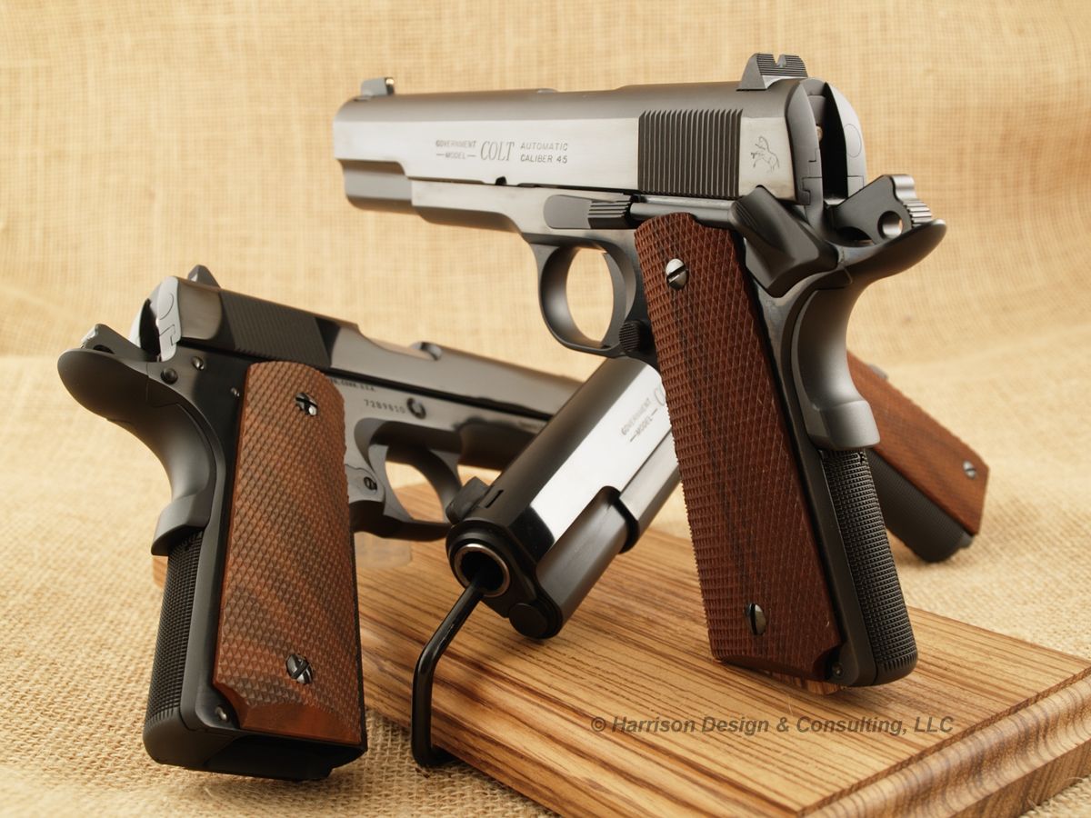

Just finished and on the way home is a set of consecutively numbered Colt Gov't Models. The frame checkering and mag well bevels were done by Pete Single. I fitted Wilson barrels with Bunker Radial Bore Bushings, H-D Retro rear sight with a H-D dovetail front carrying a domed, high-polish gold bead. Narrow pattern 40 lpi serrations decorate the top. Ball Cuts at the dust cover and Ejection ports lowered & fluted. H-D Exact-Fit Ejectors, H-D FPS and Extractors all blended with frame and slide.
H-D Beavertails with Retro Thumb Safeties. H-D Original Commander Ignition Sets with H-D Extreme Service trigger in medium length coated in black DLC. Colt slide stop shortened flush with frame -w- countersunk hole. H-D barstock mag catch checkered 40 lpi.
