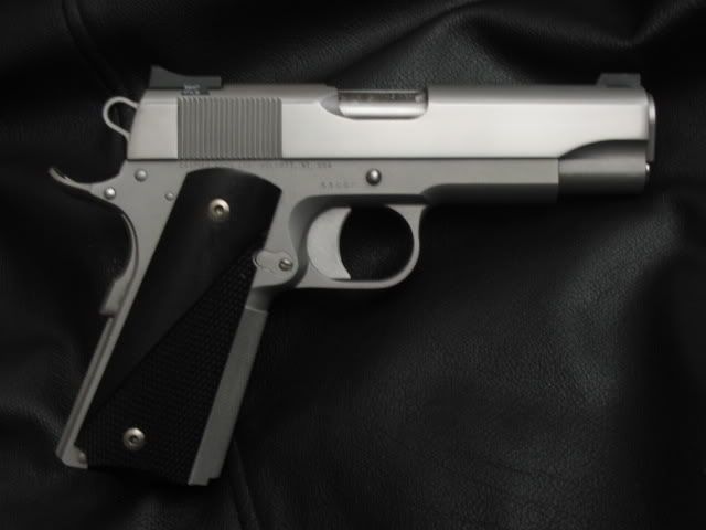

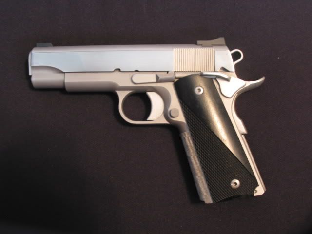

Under Ted's direction, and with a lot of help from everyone in the shop, I managed to finish a Caspian stainless commander that turned out pretty well.
Here are a few pictures.

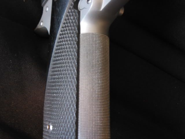

30 LPI hand-cut checkering

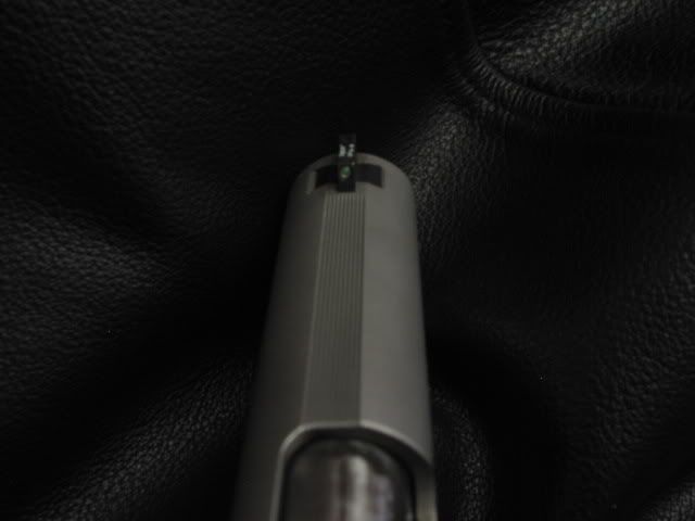

FLat top and 40 LPI serrations with tritium lamp

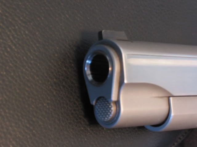

Nowling barrel with 45 degree polished crown
Brown thumb safety, 40 LPI rear serrations and Heini rear sight with straight 8 tritium lamp

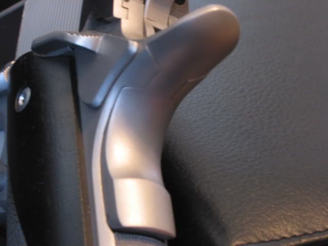

Ed Brown grip safety with memory grooves removed

Great attention to detail, especially the beavertail grip safety. It is fitted perfectly. Well done,

Lenny mentioned the gripsafety fit - some may not know that Caspians require welding to properly accept a Brown gripsafety. Zack had a little help with the weld, but none with the cleanup and fitting of the gripsafety. It took some time, but it's just what he wanted, and beautifully done.

Be proud of this one Zack, and remember - everyone's FIRST checkering job is perfect. You'll checker a Buick before you see another one :wink:
