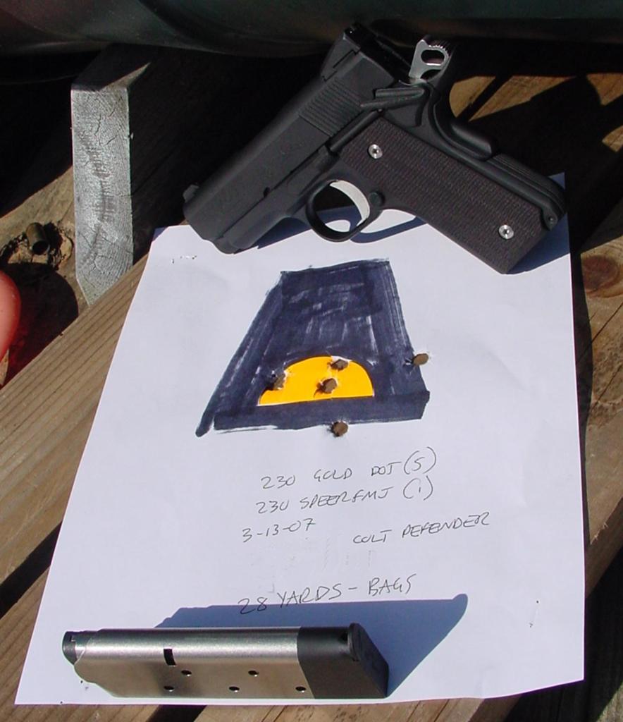

Accurate? Again, surprise, surprise. No, BIG surprise. Far as I know, nobody makes after market barrels for them.... and there is no need. Check it out:
Folks, that is six of six at 28 yards, from sandbags. Five of them are 230 Gold Dots, one is a Speer Lawman 230 FMJ. And this was not done using my usual accuracy protocol of firing the first hand cycled round off target, top off mag, fire one on target, top off mag, fire on target, etc. I just put six in the mag, racked one in, and started blasting.

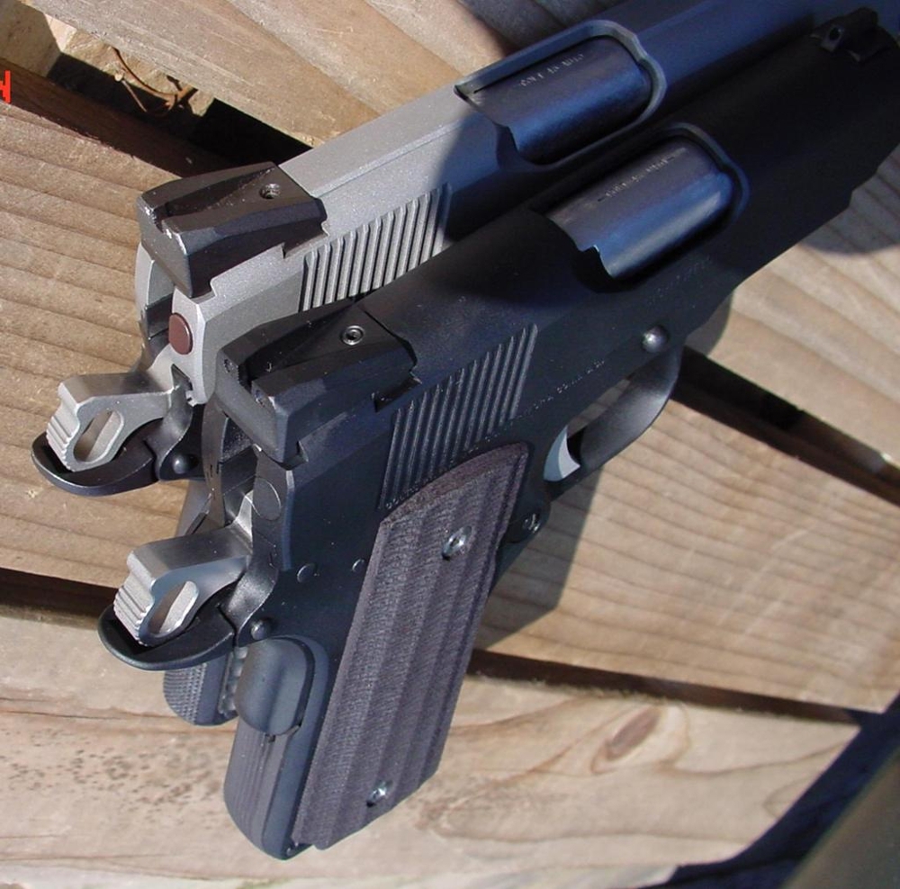

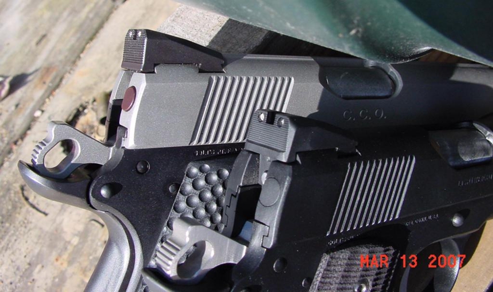

It was not so perfectly sighted in when it came in, I had to take about .020 off the rear sight. That gave me the chance to optimize the sight a little. Taking .020 off the top got me into the white dots.... very unsightly. I recut the face of the sight to remove the dots, leaning the surface forward a bit more than stock, and re-serrated it. I chamfered and radiused the sight more than stock to try and make it a little more deep concealment friendly. Drilled for tritium, recessed, Parkerized/painted/baked, sent front and rear to Trijicon for inserts. The pics show some subtle difs between the Defender's modified rear and the same sight on a Colt CCO:
That CCO BTW should by every logic out shoot the Defender. It is in fact nowhere near as accurate. There is something very different about Defender barrels when every Defender I've worked with will out shoot most any other factory-barreled Colt.
