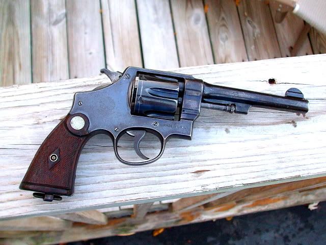

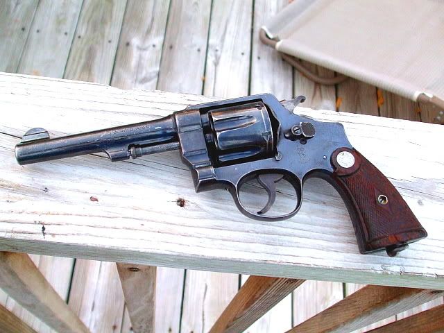

Another Option for you is to Locate a World War II Brazillian contract revolver that was designed to Shoot the .45 ACP. If the Throats are too big to suite you you could Take another cylinder from any -N-frame .357 and have it Reamed to give the Throats a nice snug fit. These Brazilian's are starting to circulate again and would be an excellent gun to play with as they have fixed sights. here is one I Picked up recently and it fires the .45 ACP fine with Moon clips. I hope this helps, Kurt
"Yeah, though I walk through the Valley of the Shadow of Death, ... I shall Fear no Evil, as I carry with me My Trusty Loaded S&W"..
