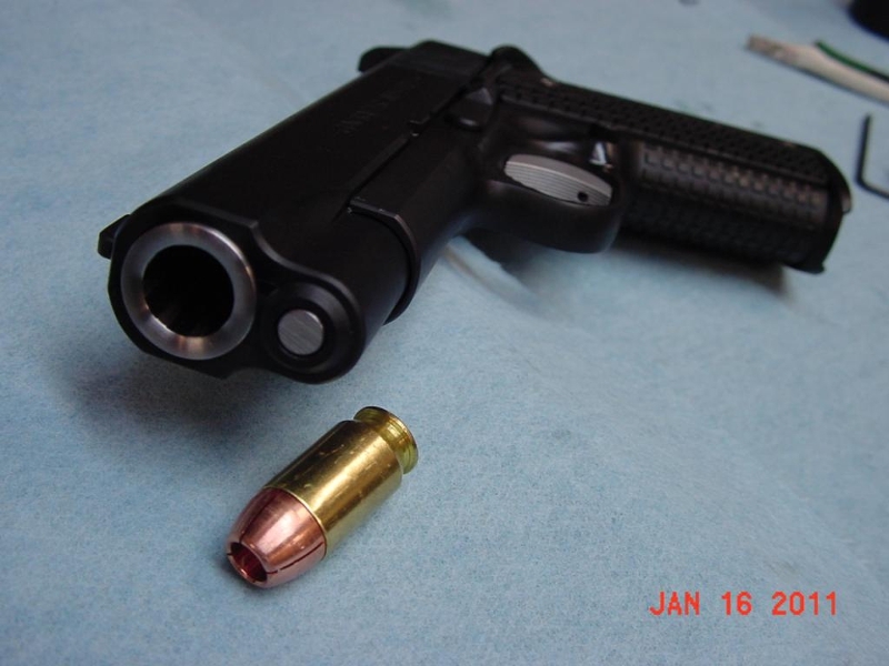

Got it done with several hours to spare. THAT's whatcha call planning!
(EDIT, 3/30/24) Original pics gone. See https://forum.ltwguns.com/viewtopic.php ... &start=300

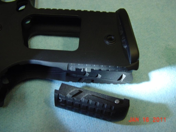

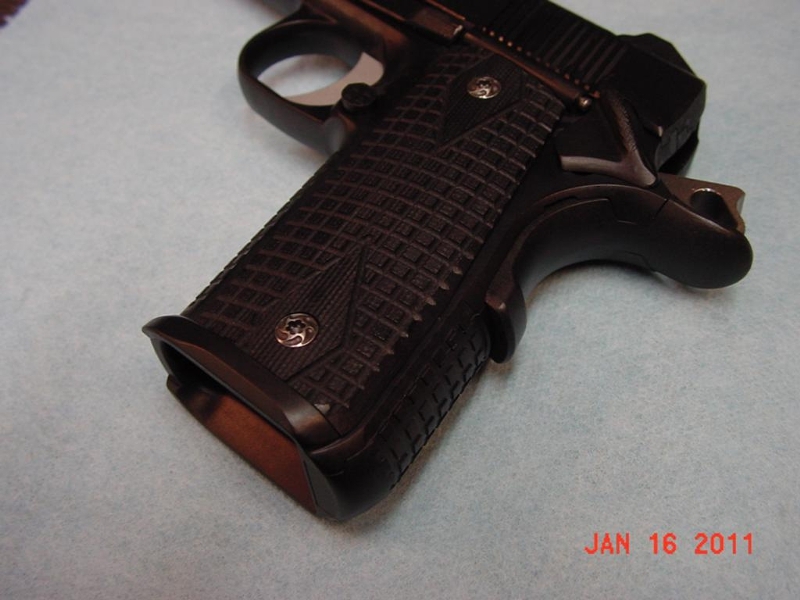

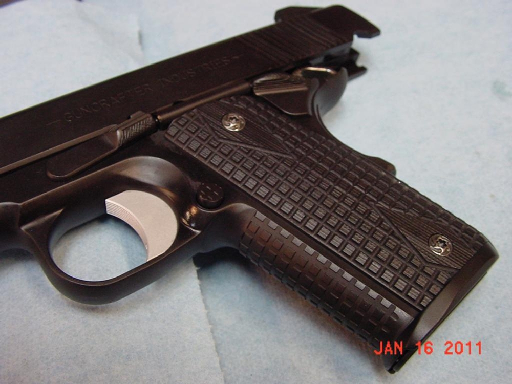

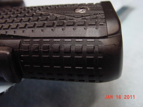

The MSH has no retaining pin-- so I could round-butt it to my heart's content. Angled slots in the frame, a lug and a protruding pin on the MSH cam it into place under the pressure of the hammer strut pushing on the mainspring.
The rounded butt and the recoil spring plug made from a 5/8" grade 8+ Allen bolt.

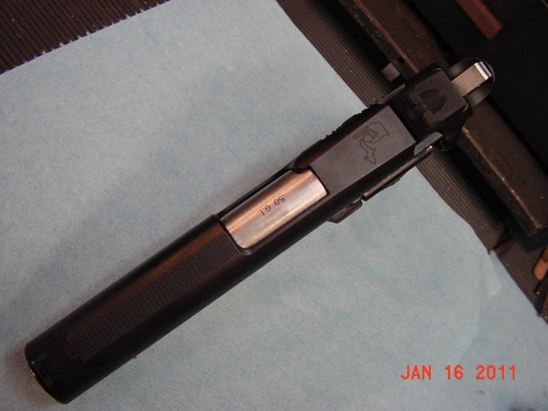

From the top:
Hope that's rounded enough 'cause it's gonna have to do.... for now.... in the process of doing this one I came up with a way to do more next time. There is also an extreme girth reduction to the MSH.

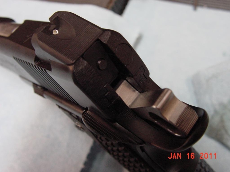

Rear of the slide. Shield Driver rear sight, made here.

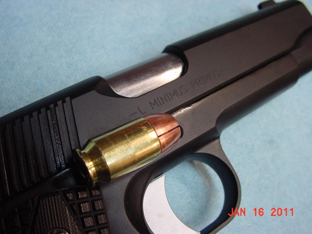

Bidness end. That's a .50 GI, 230-grain solid copper HP. They do 1000 out of a 5", this barrel is about 5/8" shorter.

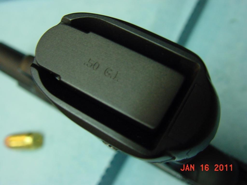

The magwell was made by me from a piece of 4130. It's not huge in outside dimensions but looks pretty big in this bottom view. No width or height added to the pistol.

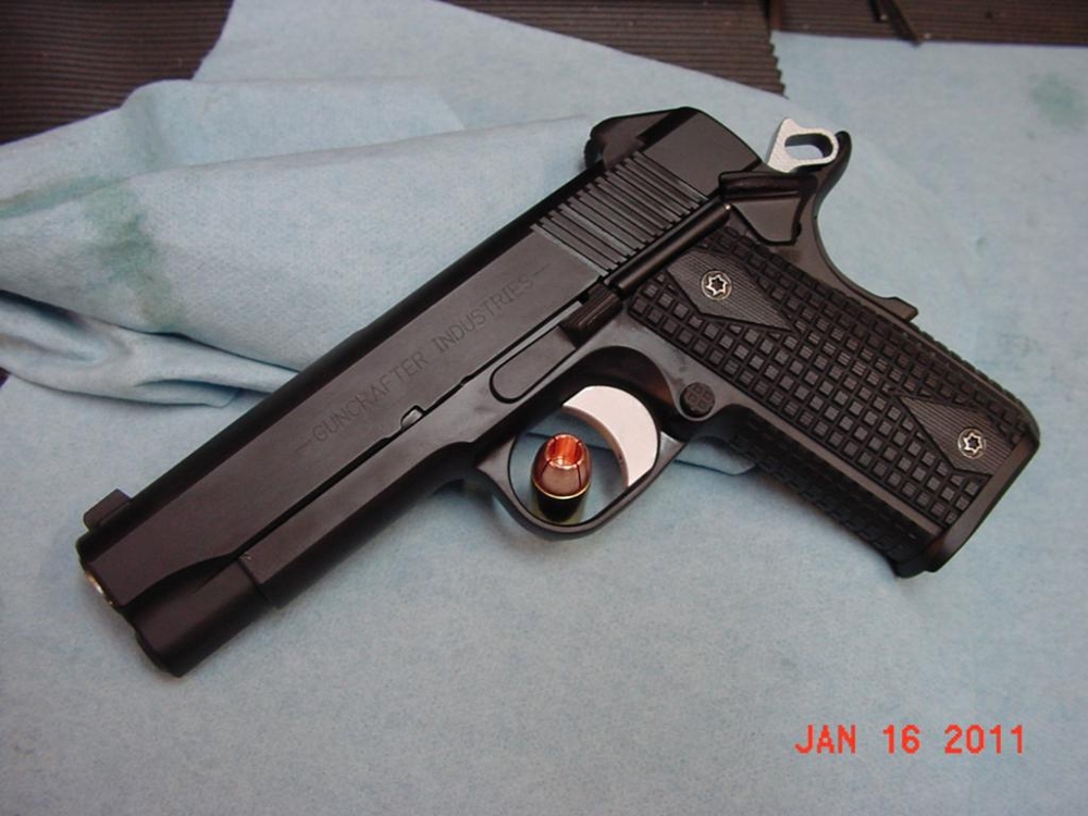

Left side whole view. I wanted to get these up but won't be able to post for a few days.
